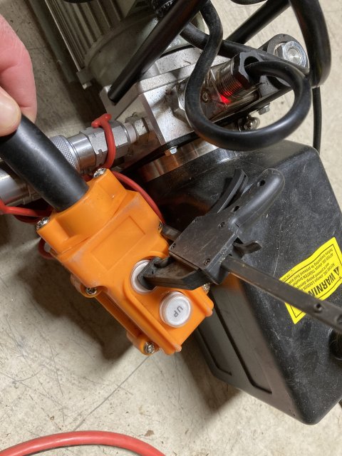

Thread Starter #14
My "Continuous Down" feature, makes connecting a snap!
