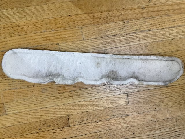

And not to sidetrack, but any flak from tracks for the chiller dropping water on the surface?
There is an absorbent pad under the chiller to catch the condensation.
20,159
That I did not know
hell on wheels
#1330
516
786
82
Saint Paul
Dodge SRT Demon
That I did not know
F34317A9-5077-40E1-AC82-3816B95F6682.jpeg If the adhesive fails and pad is out of place under the chiller.
Your car can turn into a one wheel wonder
If it gets hot out and the water drips down through the plastic covers on to the track.
8,593
52,818
That is going to be put to the test Monday on a road course, with the balance of the cooling systems. Expected 90+ degrees and dew points over 73!! It either survives or it will be for sale. It has come down to one more chance for the RE.
