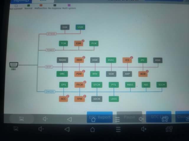

The secure gateway doesn't show up either. Makes me wonder if it's a security thing and my scan tool doesn't have the power to see it or communicate. No luck with alfa obd either. IMG_20260104_164338.jpg

The secure gateway doesn't show up either. Makes me wonder if it's a security thing and my scan tool doesn't have the power to see it or communicate. No luck with alfa obd either. View attachment 176116
Alot of stupid errors like low tire pressure and low battery voltage. Cleared everything and now all the errors are related to the adaptive cruise control modules.

Pretty easy. Click on any module/colored box and you get a menu of everything you do. Chart is cool cause you get to see everything and how it's all connected. Each group is a different can bus.
