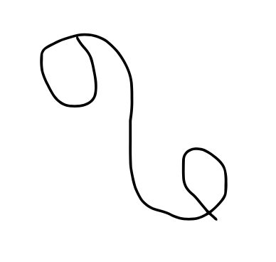

Safety wire
Interesting
Let me ponder that
just a little something for peace of mind ... and to ensure hardware doesn't back out, not that that happened, or will
and yes, I know my skill at drawing on a trackpad is somewhere below crap
16,897
52,906
Thread Starter #13
I've done more safety-wire than God.
(see avatar)
