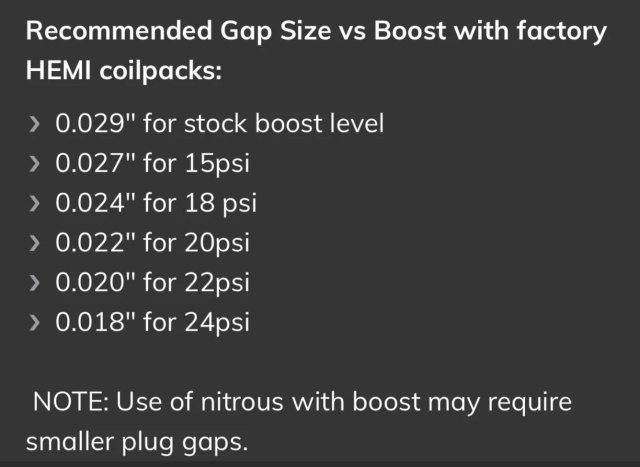

I ran .028 at 22 psi when I put my whipple on. When the car was apart last winter I went to .025. I ran .028 with my Mustang also at 22psi.
I went .021 this time around for good measure. I was making 17 lbs of boost, will be making more
Also run e85

For stock boost levels, yes. What plug gap do you run with your boost level?
3,684
8,687
At 30 psi of boost when I ran the 3.8 Whipple I was running .018”, still set there at 25-26 psi I’m running now with the 2.7 IHI blower.

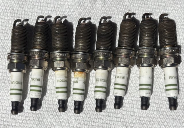

…and if you want to see what 6 year old 53k mile spark plugs look like on a stock tune redeye:
7,309
19,162
I don't see anything wrong with those plugs other than you need to romp on it a bit more often :LOL:

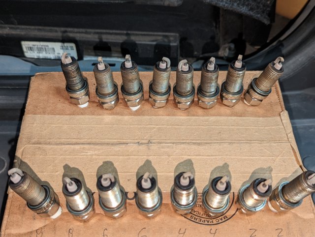

I don’t recall my stock plugs being Bosch but that’s a 2015 regular hellcat

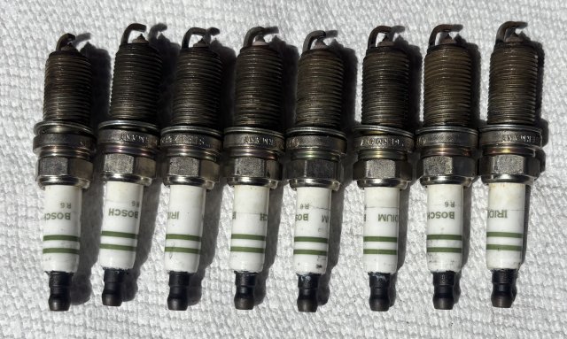

52k miles, stock 2017 HC plugs:
