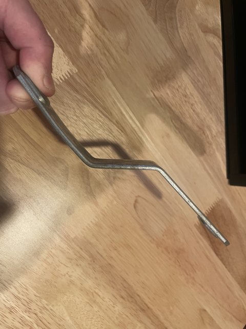

Anyone remove the bottom of their mopar rear seat delete without destroying it? Doesn't want to budge without crunching. Looking to redo a few in tank butt connector for the fuel sensing unit. Any pointers would be appreciated. Thanks
I used this
As a pry tool.
Popped right up
