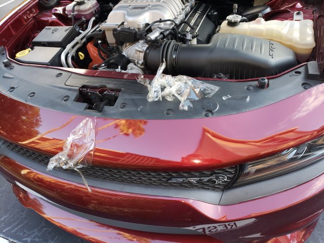

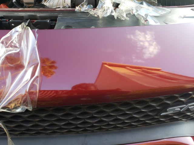

Got home from work this morning and decided to take off the 3 year old clear bra. I was worried it would be a PIA ,but it so far is coming off with ease. The old bra looked nasty with all kind of blemishes and crap. Now it looks like a brand new paint job :)

You shouldn't have a problem now after one year. I still have the rest to do, but im beat from driving a gas truck all night. It is something I am looking forward to do. it really looks bad right now, alot of stuck on crap.I am the 2nd owner seems the original didn't get into cleaning it much.

A hairdryer can help if it gets hard to pull off. Heat gun also works well, but you have to really know what you're doing ! Easy to apply too much heat & screw up the paint or warp the plastic bits.
Did you use any heat at all? Or did you just start in a corner? (Also, was it hot outside and/or in direct sun?)

It was about 83 out but not in the sun. I still have yet to do the rest of it, I only got the top strip off.

Steam is the way to go when removing it, those little sections are nothing, come talk after pulling a full hood! Most if not all PPF is 7-8 MIL thick, looks like Sun-Tek has an 11MIL film but gawd, I imagine that would suck on curvy areas!
