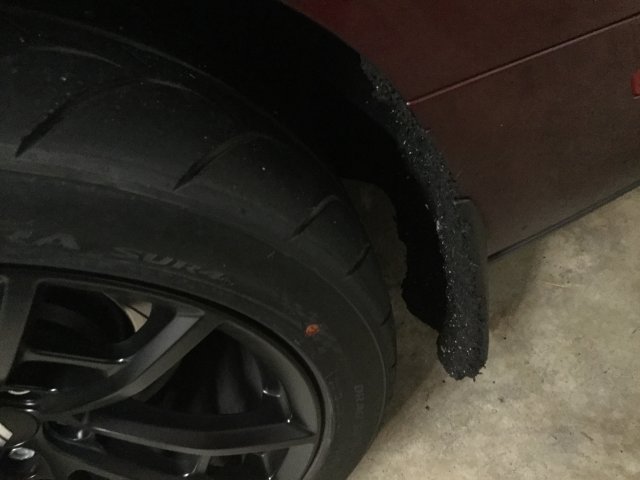

I feel your pain...
This is what I have to clean up tonight:
This was suggested to me to use in lieu of taping; it's water based so it should not hurt any ceramic coating, or the plastic wheel liner:
I've also tried slathering the liners with Mother's "Back to Black" while changing wheels; it seems to help prevent the track-prep spray from clinging too hard to the liner, but you still have to knock out all the rubbler shards.

Now THAT'S a lof of f'in rubber - NICE!!!
