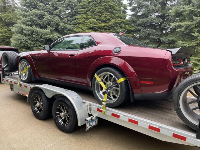

I X strap mine through the wheels since it's below the suspension. It stays tight 99% of the time, even through South Carolina on I95 north.

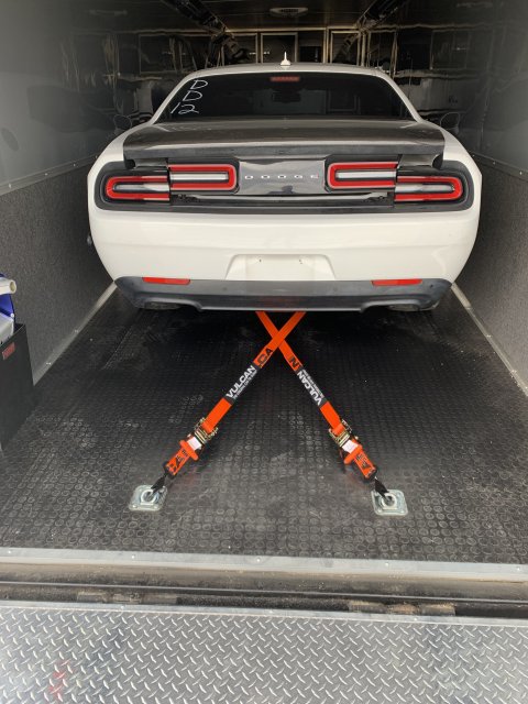

I cross them in the rear and the fronts i have straps that go through the front wheels, I use Vulcan straps and have been very happy with them. I currently do not have a picture showing the front, attached is the rear. View attachment 94531

I already had the straps with hooks for my open trailer and it does not take as long to unhook them versus undoing the strap from the ratchet portion. My car sits to low in the front and I am too fat to squeeze between the trailer and fender to try and hook the hook under the car in the front, lol
So far I have never had the straps come loose, doing it like this. My normal drive to the track is 3.5hrs or more.
Do the straps wear the finish off the wheels ?
The straps to wear the finish off the wheels ?
They don't. Never leave a mark.

The straps have a sleeve that protects the wheels from being scratched.

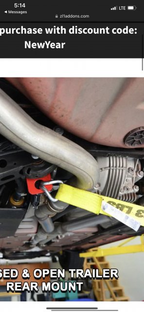

I cross them in the rear and the fronts i have straps that go through the front wheels, I use Vulcan straps and have been very happy with them. I currently do not have a picture showing the front, attached is the rear. View attachment 94531 https://zl1addons.com/collections/dodge-challenger-accessories/products/challenger-strap-points
What I am using for the rear points.
What are you hooking to on the car?

Vulcan straps- all four corners and no worries.
I really like this setup for an open trailer. No track system. I don't have rub rails but could add attaching points.

I use that red tie down piece from ZL1 Addons
I looked at them. Definitely easier but I don't trust any attachments above the suspension. It has a tendency to work loose?
Thanks, easy to do, don't have to reach under the car or add more hardware to the car or more tie downs to the trailer itself. After they are tight, no worries or no scratching to worry about. Just make sure whatever points you use onyour trailer it obviously holds. What trailer are you going to use?
