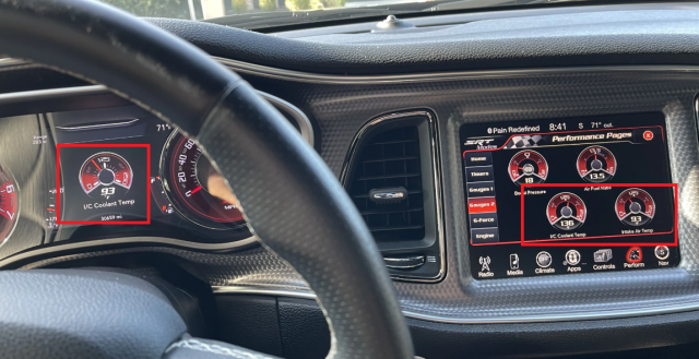

It's been several years trying to figure this out but I was able to finally track down the issue with the Performance Pages Gauge 2 Dashboard swap.
I've got the coding problem figured out. The challenge is getting the UConnect software repackaged properly so the car will authenticate/take the update.
UConnect Versions
18.45.01 - September 24, 2019
17.43.01 - January 12, 2018
17.11.07 - April 5, 2017
--- This is when the Hellcat SRT Performance Pages Gauge 2 readings between I/C Coolant and Intake Air Temp swapped ---
16.16.13 - April 13, 2016
15.17.05 - April 24, 2015
Issue (2015-2016 Hellcats)
UConnect 17.11.07 introduced a change in how the Performance Pages resolved sensor data. The updated code mapped the Performance Pages’ temperature gauges to incorrect sensor URLs (e.g., "LTR_Coolant" and "IntkAirTempIntrClr") referenced in the I/C Coolant and Intake Air Temperature Dashboard Views, resulting in a mismatch between the displayed labels and the underlying CAN signals.
The instrument cluster was unaffected because it continued to reference the correct CAN sensor IDs. This is why cluster readings for I/C Coolant Temp and Intake Air Temp remained correct, while the Performance Pages began showing cross-mapped or inverted values starting in 17.11.07 and all later releases.
Potential Fix
Dodge needs to patch the Performance Pages App for 2015-2016 Hellcats with the following corrections to Gauges 2 Dashboard files.
File Location 2015 (LA Challenger):
UConnect 18.45.01 version > swdl.upd > secondary.iso > usr > share > xlets > kim_packages > KIM18 > xlets > 7DEC7834-535D-47B5-BD33-695477EDCD57 > prog > jars > GSkills_MY15_LSeries_v02.01.01_FIT.jar
File Location 2016 (LA Challenger, LD Charger):
UConnect 18.45.01 version > swdl.upd > secondary.iso > usr > share > xlets > kim_packages > KIM22 > xlets > 7DEC7834-535D-47B5-BD33-695477EDCD57 > prog > jars > GSkills_MY15_LSeries_v02.01.01_FIT.jar
Current in 18.45.01
IntakeAirTempDashboardView.class -> IntakeAirTempICSensorModel.getInstance()
CoolantTempICDashBoardView.class -> CoolantTempICSensorModel.getInstance()
Software Patch Needed (2015-2016 Hellcats only)
IntakeAirTempDashboardView.class -> CoolantTempICSensorModel.getInstance()
CoolantTempICDashBoardView.class -> IntakeAirTempICSensorModel.getInstance()
This is because the current CoolantTemplCSensorModel references "LTR_Coolant" and IntakeAirTempICSensorModel references "IntkAirTempIntrClr". When the wiring was changed from MAF to IAT sensor in 2017, the signal referenced by "LTR_Coolant" is now the post-intercooler charge air temperature, and the signal referenced by "IntkAirTempIntrClr" is the coolant temperature flowing through the low-temp coolant circuit and intercooler pump.

Hellcat
Thread Starter #14
Decided to code an alternate route and just switch the data labels on the Dashboard.
So the Performance Pages file is updated. The one caveat, this would be specifically for 2015-2016 Hellcat Vehicles.
Unfortunately, the next step is to get the update to authenticate, and that might take some time to figure out.

Ok, I want to confirm this, but I also want to make 100+% sure I understand what you've all been saying this whole time...
I want to confirm this because having never seen it, it is foreign to my understanding, so, you know, certainly is a fickle thing...
My center display gauges do in fact match the gauges in the Uconnect, and what you're saying is that the center driver's display has gauges swapped, correct? (I know, but I'm just being as clear as I possibly can be, being that MINE DO MATCH...)
My HC is a MY2016 M6 Challenger with Uconnect 18.45.01
4,689
18,912
It's the I/C Coolant & Intake Air Temp that are 'switched' on the G2 screen on our cars. They seem correct on yours tho, so it looks like it is not an issue for M6 cars.
I was thinking about getting the last map update, but it requires going to 18.45.01 which (reading some threads & the install instructions) can be a real problem to get applied. The dealer said they wanted $250 to do it as it frequently fails and has to be redone :oops:. Did you install that yourself or did it get applied before the 4g business killed the OTA updates ??
52,899
I've done all of the updates manually via USB stick.

Thread Starter #18
Nice! I'm also running 18.45.01 but I'm going to reflash to see what happens.
Otherwise, another workaround might be Engineer Mode on the radio and retrograde to an older UConnect version. Based on your screens, this seems like a 2015 Challenger problem.

Thread Starter #20
Similarly, 2015 Challenger Hellcat with 18.45.01 reinstalled.
Also, nice catch @MikeD1 on the Gauges 1 page. Looks like we have Trans Temp sqweezed in there.
