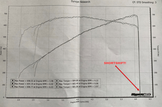

Here go my dyno results taken in March. The runs look pretty consistent as there were 3 pulls back to back. To be honest, the dyno operator didn't seem too knowledgeable and I think he left the car in its default startup mode and not in Track or Sport. He also shortshifted at 6200rpm. It would have been nice for me to break the 700 wheel hp but i know it's there...and that's a little over 800hp at the crank so not bad for stock!
7,309
19,162
What if any correction factor? Revved out to 6400 I think that definitely cracks the 700rwhp mark.
