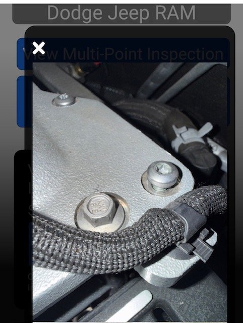

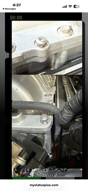

Has anyone seen this? Durango hellcat, completely stock, 40k miles. Took it in for an oil change and a full awd service with front, rear diff with transfer case and dealer noted this. They asked if i had taken the blower lid off for some reason. Of course I had not, They did tighten them back up at no charge but cant understand how this happens.

I've been checking those bolts as part of the initial new vehicle check (fluid levels, fastener tightness, etc.) since '20 or so. Haven't found any truly loose ones yet, but knew that it's not unheard of.
Low fluid levels (except on Durangos) is pretty much standard, and unevenly torqued lug nuts is common. Which is why the vehicles are checked before being driven for the first time.

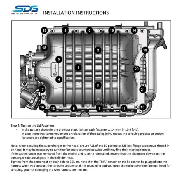

Here is the best reference from Jesse at SDG performance on torque sequence and specs for the fasteners
