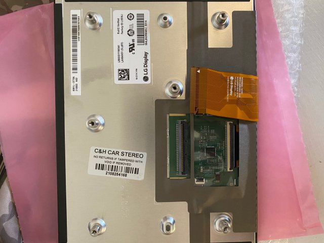

I went with the Option 2, as it was the easiest fix. Research showed that the initial Touchscreen / LCD part # ended with (1), whereas it was later revised twice to (2) and finally (3). Most people have reported that the (2)/(3) parts will not bubble or delaminate as they changed the glue. However, these two parts are harder to come by. The (1) parts seem readily available on ebay, but will ultimately delaminate again. I found a seller who had (2) part and contacted him via ebay. By the time he responded, he had sold it, but confirmed he was ordering an (3) batch, mostly for his repair business, but a few more to sell on ebay. He gave me a headsup and I ordered the (3) right away. I believe it was $650, plus tax, plus $9 shipping from CA; so it wasn't like I had to wait for it to be imported from China.
The below Youtube video will walk you through the entire removal and install process (not mine, but very informative). This is VERY easy and I think anyone that can turn a screw driver could do it. The only snag I had was removing the interior trim (Challenger ); the upper right side would not pop off; was using plastic interior trim removal tools. That one clip ended up breaking off...I think the clip was defective from the factory as I had a real hard time removing it from the bracket even after it broke off from the trim. I just super glued it back on and it popped right back in no problem upon reinstall.

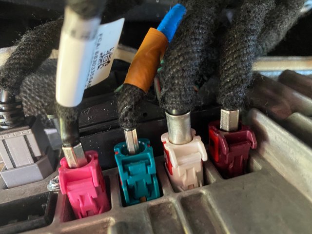

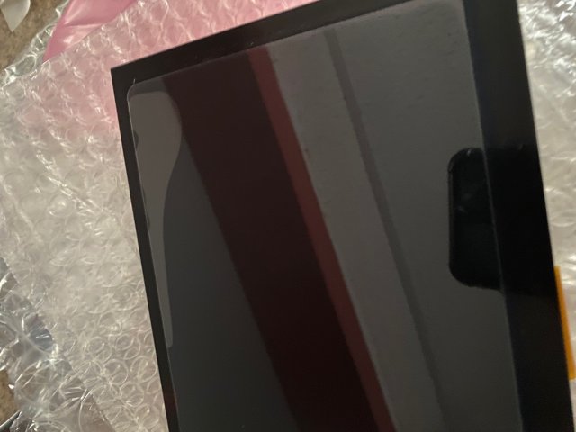

Below is a picture of the old screen where you can see the bubbling. Also is a picture of the part #3, showing the (3) designation. Also attached a picture of the rear connections should you forget where they go.
