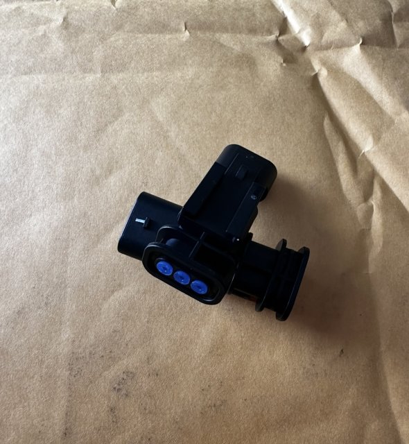

Exhaust is being removed for the track midpipes back. I'm assuming this will set a check engine light. Can the active exhaust valve trouble codes be disabled? Yes, I'm tuned. Thanks!

ZAutomotive inactive exhaust plugs will do the trick....run them on mine for years now after I cut out the flapper valves completely

CELs turned off and made my own plugs out of the same connectors for $5 to keep water out of the connectors in the factory harness
