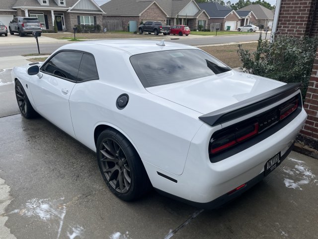

I have a narrow body challenger, but have Phillips performance fender flares and have a 11.5 wheel with 335 30's on the rear.

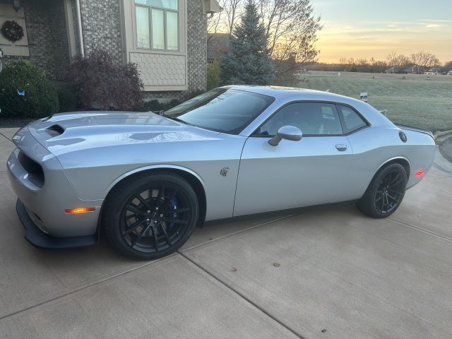

Welcome! Here’s 10.5 rims with 305 nittos on back and 9.5s with 275s on front.

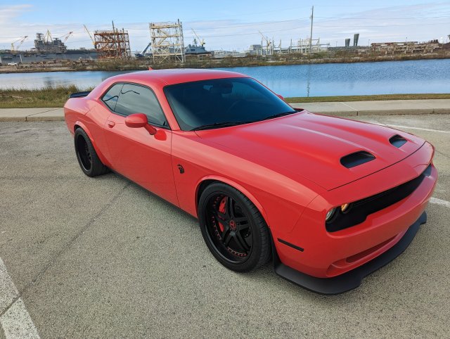

This is where I ended up, 305/35 Michelins for the street on 10.5 in replicas and then a drag wheel/tire set up when I'm feeling frisky or hitting the test n tune.
