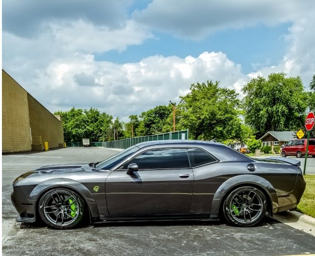

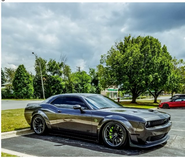

H&R Springs so far. She drives so much better and wheel hop pretty much non existent! I have an 18 WB M6 so it was bad. Brace and Springs so far so good. Screenshot_20190821-134451_Chrome.jpg Screenshot_20190821-134251_Chrome.jpg
