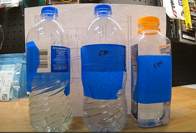

I have a picture of e85 from three brands in clear containers. Lemme see if I can find it....do have to insure it's good stuff.

These were from my local E85 pumps. I think the one on the left is Thorton's the one in the middle Mobile and the one on the right is for sure Speedway.
Left = E75 - yellowy in color and smelled funny - not like moonshine or gasoline something else. I would never run this in my car due to smell and color.
Middle = E80 - was cloudy with some odd stuff floating in it - can't see it in the pics but looked like very small white particles. I would never run this in my car due to the stuff floating in it.
Right = E80 - crystal clear and mostly smelled just like moonshine with a "hint" of gasoline. This is the Speedway brand and this is what I've always used in my cars. I check it spring and fall to see when they switch from summer to winter blend and it's always crystal clear and smells like shine. Lowest I've ever measured was E70, highest E90. Most of the time it's E85 exactly.
The point which Mike already made is that you really need to know it's good E85 if you're relying on it as pump E85 is not all equal.
