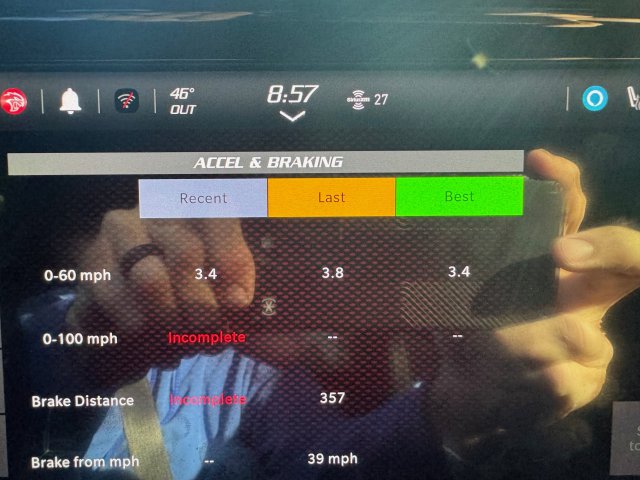

I finally got past the 500 mile break in......this morning I tried a couple of 0 - 60 runs. Both were on foot brake.
First one just launched with not raising the RPM's....3.8 sec. Next run I foot braked and raised the RPM's to 1800.
She went 3.4. Only mod is the JLT intake.

Good sprint! Do the launch control sometime and let’s see the difference. That is getting into some real respectable territory.
