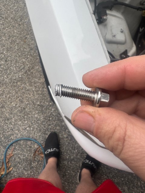

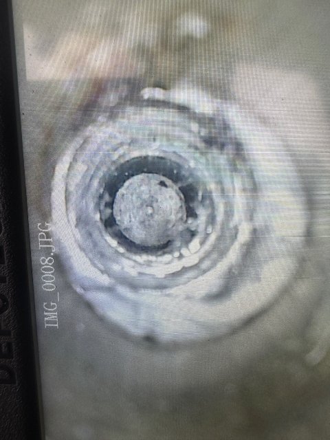

Had a shit ass time at Cecil doing licensing passes, fuck that noise. Also kept blowing couplers off.
IMG_9363.jpeg The fix...

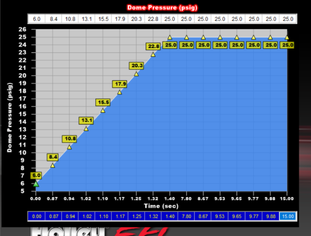

IMG_9364.jpeg Learning so much at the track. How to launch a car on the Holley. Left suspension alone, pulled some timing at launch and she was making some power. Still hitting boost cut. New setup though so we out here testing.
