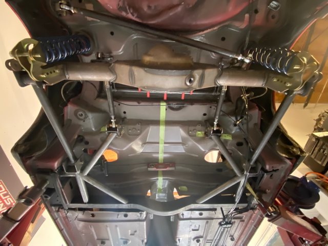

I had a thread on the other forum but I stopped maintaining it after I started coming here. It doesn't have any of my recent endeavors or anything about my current setup with the 428 stroker and 4.5L Whipple. Maybe when I get some time to myself, I can put together something here.
For now, I guess I can list out my mods.
Basic setup
225 shot of Nitrous on a built stroker motor with a 4.5L Whipple on top pushing power through a factory upgraded HP90 8 speed transmission.
Weight is a touch over 4300lbs with driver
Build Details:
- Demon Performance/TKM Built 428 Stroker Motor
- Thitek Custom Heads
- Demon Performance Blower Cam
- Paramount Performance Built HP90 A8
- Whipple 4.5L Supercharger
- Nitrous Outlet system with custom nitrous spray bars
- Killer Chiller with extra 1.25 Gallon Intercooler Reservoir Tank
- Genuine Lower Rate Dodge Demon Front Springs
- Menscer / Reed Performance Rear Double Adjustable Racing Shock and Spring
- Injector Dynamics ID1700
- Fore Triple Pump Return Style Fuel System
- JMS FuelMAX Dual Output P2020 Boost a Pump
- Stainless Works Long Tube Headers
- Mopar 3.09 Factory Rear Differential
- BMR Upper Control Arm, Upper Trailing Arm, and Lower Trailing Arm, all with upgraded Delrin bushings
- BMR Solid Cradle Bushings
- Per4mance Development DIRS Diff Brace
- Per4mance Development Billet Front Diff Race Brace
- TCE 15" Rear Brake Conversion
- High Horse Performance / Bogart 15" Rear Beadlock Wheels
- Mickey Thompson 315 ET Street Pro Radials
- TCE 15" Front Brake Conversion
- RC Comp Hammers 15" Wheels
- M&H Front Skinnies
- Driveshaft Shop Aluminum Driveshaft
- Driveshaft Shop 1,400 Half-Shafts
- Anti Gravity Lithium Ion Battery
- 180 Degree Thermostat
- ZAutomotive Tazer
- ZAutomotive Double Bypass Cable - allows use of Tazer + Datalogger simultaneously
- Custom Modified RPM Roll Cage
- Stroud Parachute on custom mounts and hardware
- ATI lower with Hpindy's underdrive accessory pulley ring

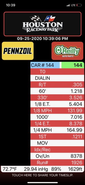

I don’t think he believed me but then he prodded me for more info, asked what do I trap? 164 I said and the look on his face was priceless. Anyways, fast forward to the actual race and this is what happened.
I was told the track wasn’t gonna be that great so I decided to go with less nitrous and slower ramp than my previous 8.41 pass from a month ago. Watch the video for what happens next!
It was a close race! At one point he almost caught up to me but then I pulled away on the big end. His car or his lights kept popping in and out of my peripherals all the way down the track, it was pretty awesome.
Here’s my slip, reset my PB in every category pretty much including a scorching 1.21 60’.
