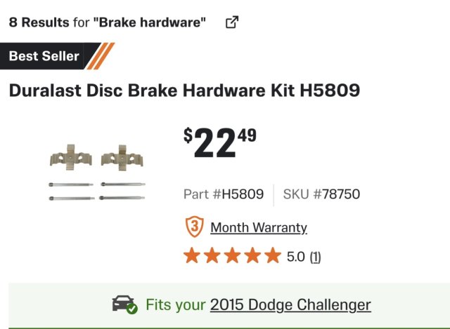

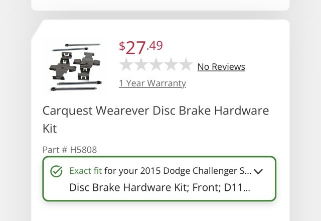

Duralast makes it too, might be available on Amazon
8,877
7,790
Duralast ones are from autozone

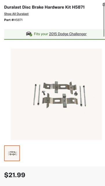

Above were for the rear, these are for the front

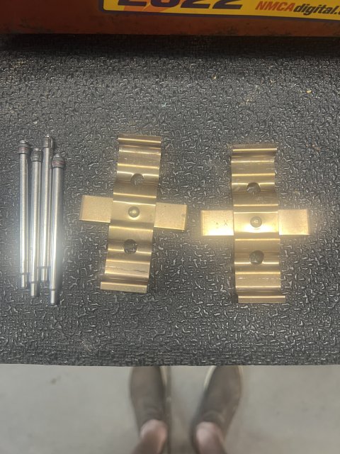

Did you use the PS items when you installed them? Did you keep the OEM if so? Or vice versa? I do have a couple sets of the retainers and pins laying around. Let me know if I can help you out. Cheap to send you a small package. It has to be something that easy.
I think I reused the OEM stuff.

Well I did finally read the balance of the thread. If you can find the PS hardware try it. I see you can order a set. Or you can tell me to go to the shed and find a set to send to ya.:love:

Got a set on the way from @jgilg.
