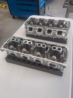

AlleyCat
AlleyCat
#1332
970
853
Oro Valley
16 HC Challenger
Thread Starter #25
Mechanic states they are very pretty!

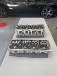

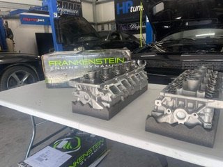

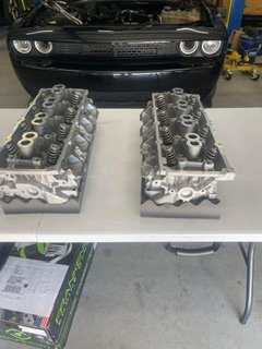

Thread Starter #27
Frankenstein stage two fully assembled with slightly larger intake valves. Once together it will get dyno tuned remotely on my mechanics dyno.

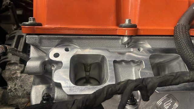

Thread Starter #40
