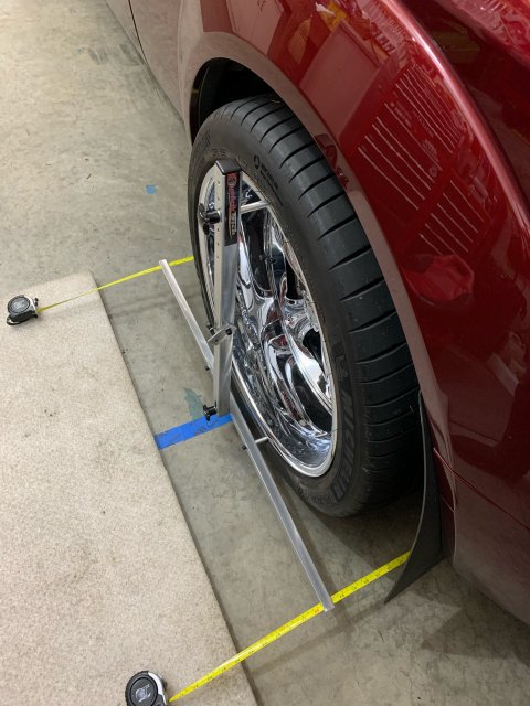

I wish I could help out with the toe adjustments but I'm just getting set straight on camber.
We got all AAD minus the toe rods at the moment and with parker's recommendation for #6 tabs I am at -0.4 left and 0.0 right. I will probably step up to #7's to see the change it makes before going to a #8 or seeing if Parker can spin off a custom 7.5 tab.
Toe is set to -0.05 each L&R and 0.0 thrust angle as a result. This appears to have at least severely minimized the rear end "oscillation" or wobble I had under HARD acceleration. Before measurements were -0.13 and -0.43!!!!
I have not touched the factory settings in the front whatsoever. The toe rods are next.
