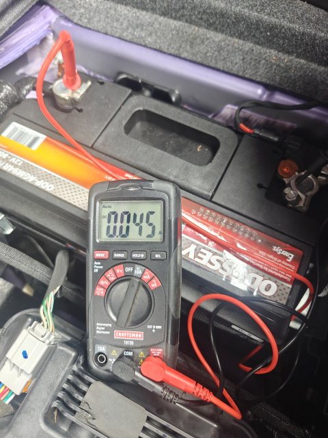

I also disconnected the negative terminal and ran the multimeter in series, which showed around 4 milliamps, which is normal.

4 or 400 mA?
4 should not drain a battery and is very low compared to normal, 400 is high and might be a problem, while I don't have a tech manual in front of me, my best memory was 100-150 was normal??

Oops, autocorrect got me, fixed

My bad, is 45 milliamps...but I read in newer cars this is normal, but I have no idea to the truth of that.
