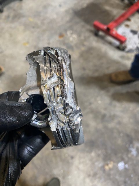

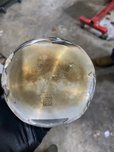

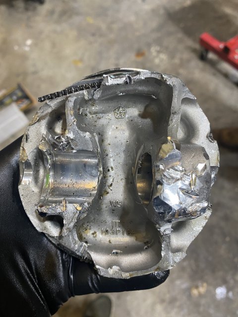

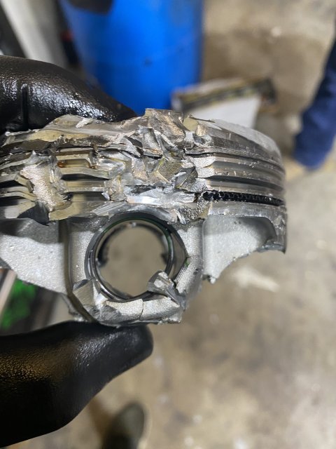

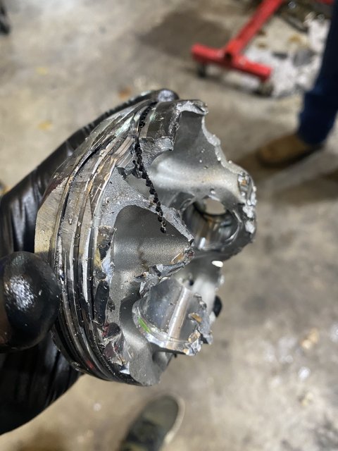

Update. Finally got the block stripped and piston #3 out of the block
Head can be repaired, now to get the crank checked out and decide my plans.
Wrist pin is in one piece so I'm going to assume the connecting rod broke

That's some carnage
The top of that piston is pretty clean...
E85 (and nitrous) they were all clean. One of the cleanest engines Ive ever stripped down. It is low miles, but I was still amazed how clean everything was
