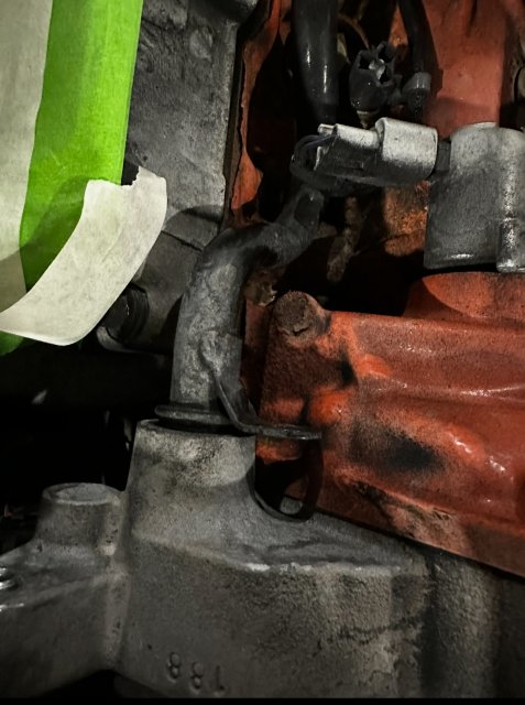

So this is odd, this is the passenger side heater core pipe. Anyone have pictures of their front cover/valley where this goes in? Very strange, something’s missing
U
Thread Starter #28
I’ve had the supercharger off a million times and never noticed this. Why is my front cover missing the nub for it to bolt onto

Is it cracked off? Might need a new timing cover--or weld a piece on, machine/grind it flat to match, and tap it.

Thread Starter #30
No nothing was ever there

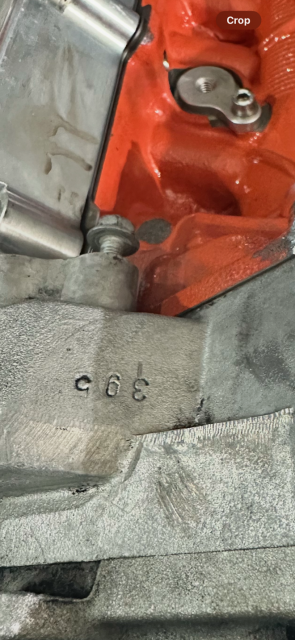

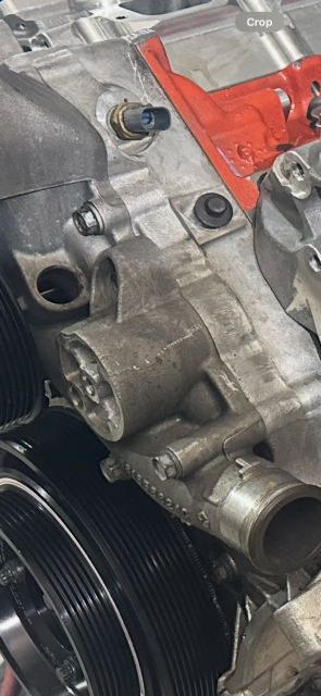

U
Thread Starter #31
This is an early 2015 m6. Anyone else have one and have pics of their valley? This is weird. No idea how I didn’t notice it when put the 2016 hard pipes in

I wonder if @fumanchu182 remembers if his didn’t have an extra nub on passenger side to bolt to
#34
I have no god damn clue what you are talking about.
7,309
19,162
I think he's expecting a threaded boss to be where that bracket with the hole in it is to bolt the heater pipe to the block and or timing cover.

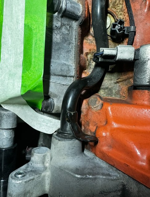

U
Thread Starter #37
Is that a factory hellcat timing cover? Every hellcat I've worked on has a 10 mm bolt to hold that on.
Yep, factory.

#38
both tubes should have a mounting bolt to hold them in place on the timing cover.

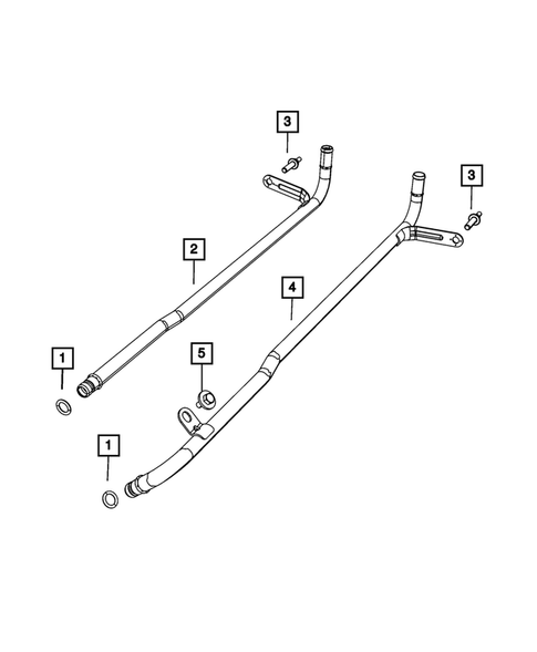

#39
as per mopar notice the passengers side doesnt have a tab, wonder what year this changed. Also the catalog has the wrong part identifier. Its all screwed up.

Thread Starter #40
Well, my car is an early 2015, and the hard lines are from a 2016
