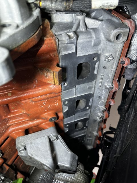

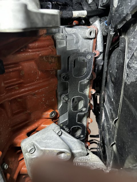

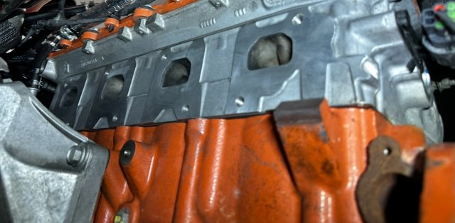

Finally able to get back to it. Nice and clean.
1,522
2,133
U
Thread Starter #113
Thanks, definitely took a lot of elbow grease to get the ports clean and all the carbon off. 3m white roloc with 90 degree angle die grinder and red scotch brite sheets. I recommend a little wd 40 with the bristle disc, scubs more instead of marring the surface
Perfect, credit for doing it in the car. That makes it pita. Everything looks clean. 👌

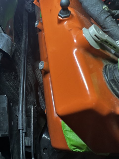

Thread Starter #115
That's clean..:unsure::unsure::unsure:....man...I sure hope yer personal hygiene is not on that level:rolleyes::rolleyes::rolleyes::oops:
Holy guy...I'm kinda gettin the feelin you really don't care for me :rolleyes::rolleyes::rolleyes:

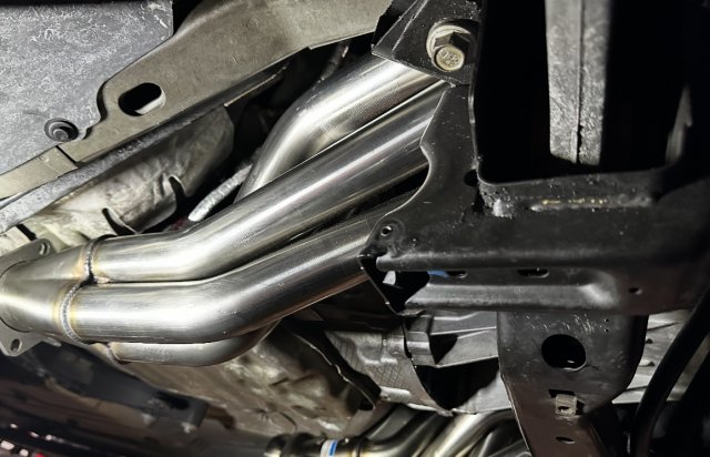

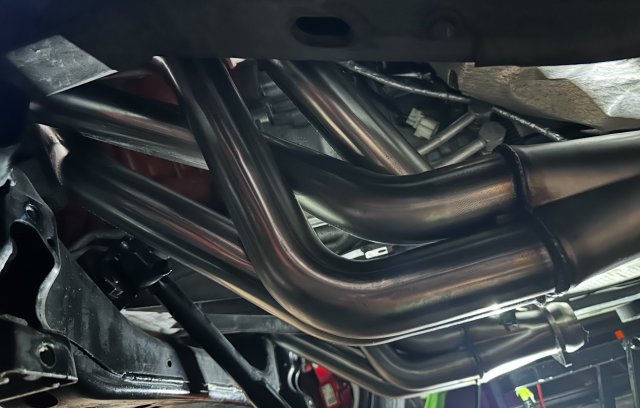

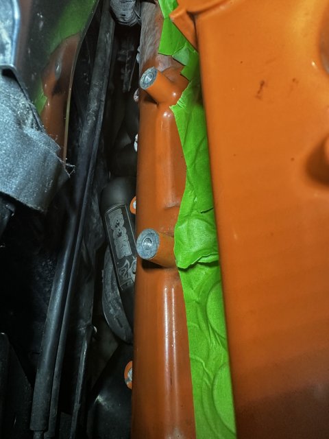

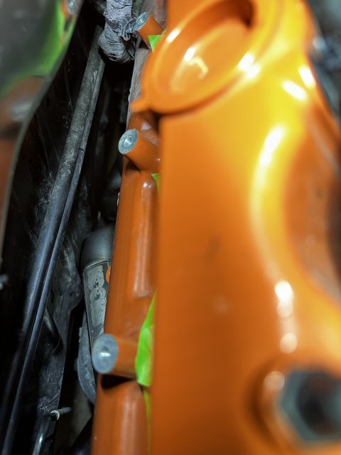

Ok, looks like I might be running into an issue. Still need to torque and crush the gasket, but I’m still not sure that’s going to give me enough room. Is anyone running the 2” primary kooks long tube headers on their challenger hellcat? How much room do you have on the passenger side? 1 pipe is just hitting the ribs on the shock tower on the passenger side. After I crush the gasket I “should” have room, but just a hair. Anyone that could take/post some pics I’d really appreciate it
U
Thread Starter #120
