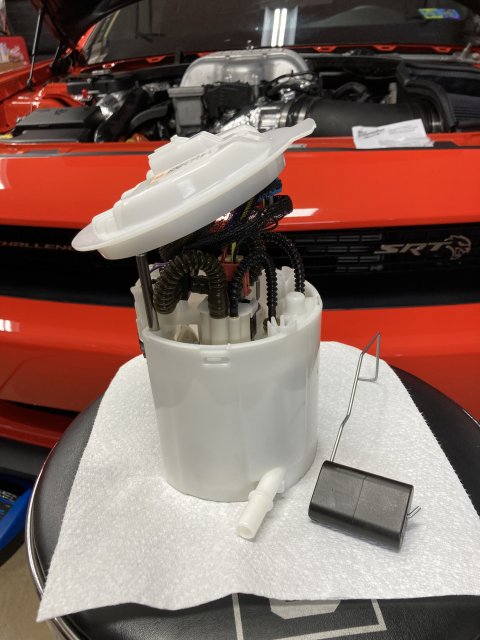

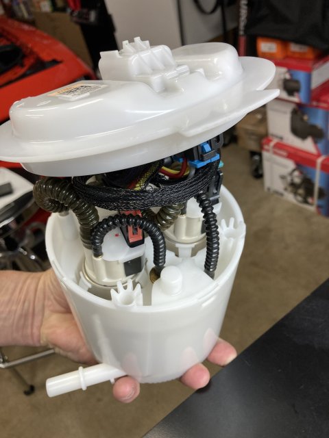

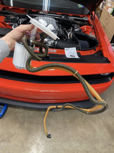

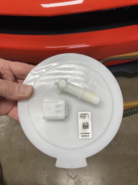

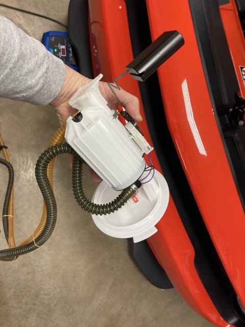

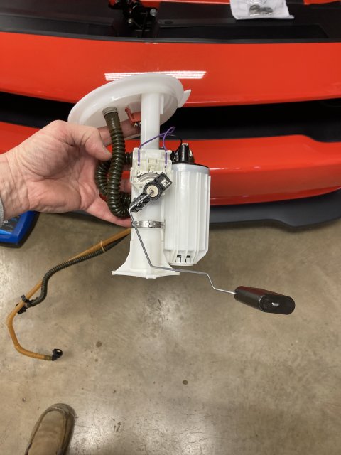

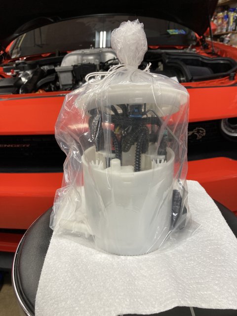

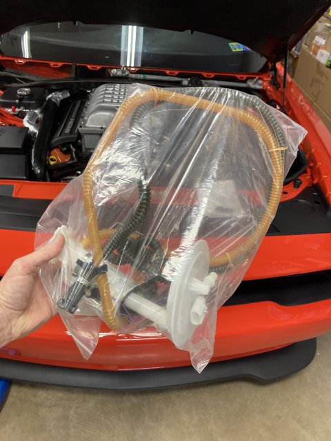

There is no pump on the passenger side, only a fuel level sensor and a device that looks like a pump but has no wires going to it, ie it’s not a pump! Fuel is pulled from that side by a Venturi effect from the primary pump (or pumps if a Redeye). If it were me I would be highly questioning my mechanic on this. Picture of everything that’s in the fuel tank under both bungs.
IMG_4053.jpeg IMG_4054.jpeg IMG_4056.jpeg IMG_4057.jpeg IMG_4058.jpeg IMG_4059.jpeg IMG_4060.jpeg IMG_4061.jpeg

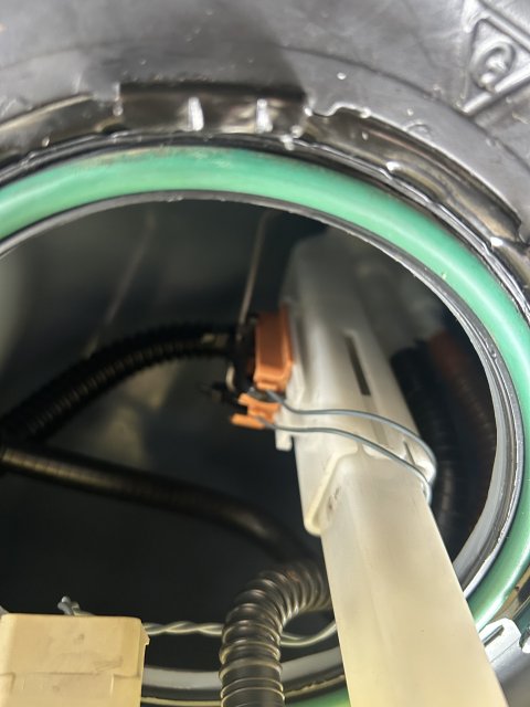

@16GoManGoHC2 can I take you up on your offer?
mechanic got the tank out, found out that the secondary sending unit was broken. Not even the whole unit either. Just the orange bracket and the fuel level arm. IMG_5995.jpeg

Wow, that picture came out great. :D They got it working kind of. I got my fuel gauge back, but I still want to replace that secondary unit. It's a little off. When I filled up the tank, it showed just a hair below full. They kind of rigged the level arm to work, but I'll replace the unit myself.
