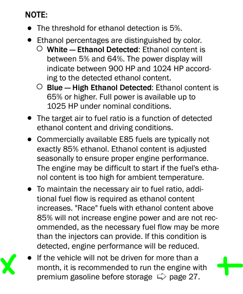

Is there anything in the manual about running regular gas in it from time to time?
I doubt they recommend leaving E85 in it all times
Here you go
6,060
21,518
I hope 170 buyers read that.
Then read it again.

On the 170, I think it's a critical point that it makes full power on E65. People are already just dumping E98 in the car which not only isn't helping, but likely hurting their performance. I'd personally shoot for around E70 to E75 to keep pressure off the fuel system.
