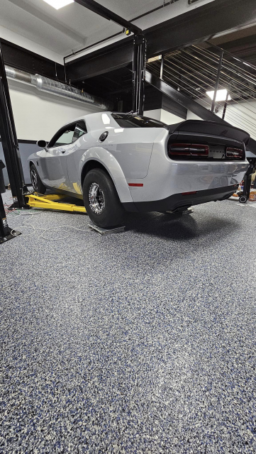

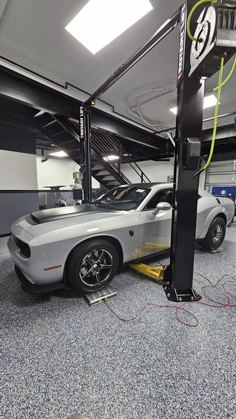

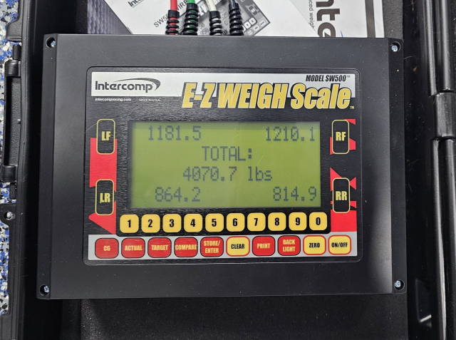

4178.9 stock
4070.7 with the 15 in conversion and new wheels/tires.
108.2 lbs shaved
48.4 from the wheels and tires
59.8 from the brakes.
I have a braum seat I'll be putting in the car next.

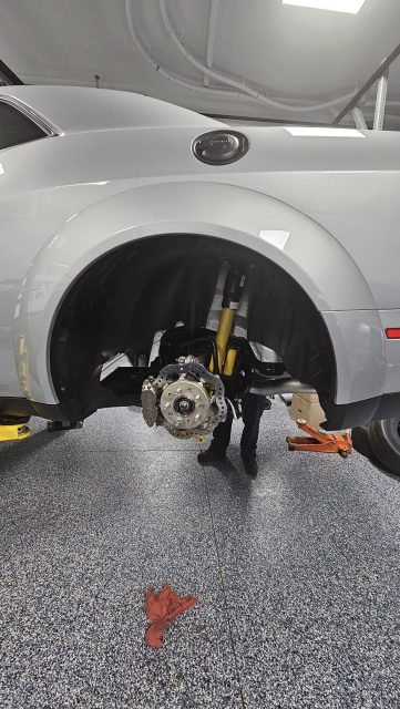

What rear brake?
59,706
207,883
Thread Starter #395

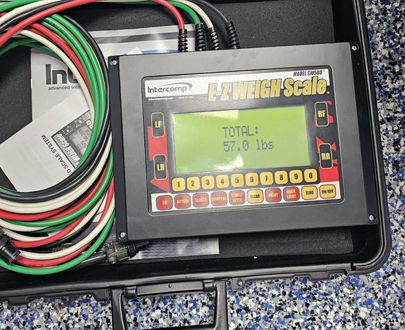

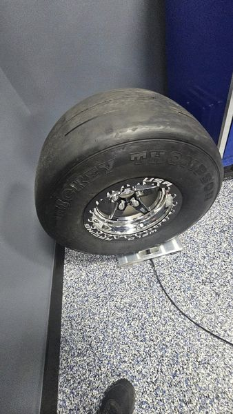

Weld with 15 in rear
Front 27
Rear 57
Total 168
48.4 pounds saved

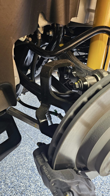

crazy looking support bracket on these cars

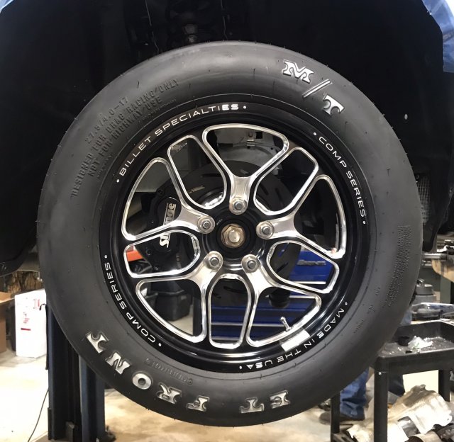

What's the lightest front wheel tire setup and cost?
My Racestar Darkstar 18x4.5 setup with M&H Racemaster front runner is 38lbs looks like current prices have the setup around $1100 to $1200
These tires are DOT if that matters.
My 17” Billet Specialties Comps and M/T Fronts are 22 lbs. CBDD8B80-1B8F-4380-93D2-FC408039978B.jpeg
