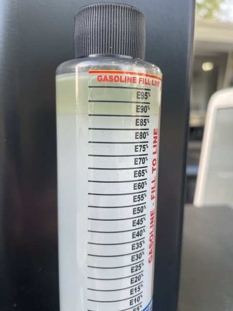

Man that's cloudy.

@Speedy! Of course it will be in the tester.

Man that's cloudy.
my thought to but did he shake it then take a pic? I spin mine around a couple of times and it isn't to bad. I know if it sits for a bit it looks clearer

This is what mine looks like here. Even when I shake it it's not very cloudy....you can see the gas or whatever and the alcohol in dispersion, but it's still clear.

Surprised it’s so bad. We have a station here I’ve always had good luck with 15 minutes away. It ended just a smidge shy of 85 so prolly 83. But in the water bottle it was as clear as water

I'm not sure if cloudy matters or not but clear makes me feel better.
