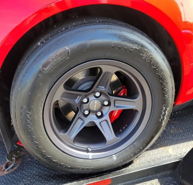

Yeah it's kinda odd. The old MT ET Street Rs I had moved about 2 inches the first time out then never moved again. These just kept on moving. I even aired them up to 35psi and let them set for 2 weeks after mounting per my normal procedure. Maybe the tire guy used too much lube or something, dunno.
Bead locks would obviously solve it but that means buying new wheels, dealing with the bead locks, etc. Nah.

I never had a set that didn't slip some each run from new. At this point I've run 2 sets of MT 315/50's on Welds and 2 sets of MT 305/45's along with 1 set of the Hoosier DBR's all on Billet Specialties. All 5 sets consistently slipped from the word go.

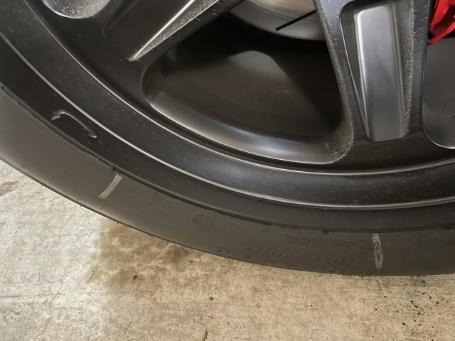

This was after 4 passes with some sticky stuff on my beads after thorough cleaning. I have tried a few things, and they always move and get out of balance at the track.
I run about 18 lbs of air and run high 1.49s-1.57s with these tall tires. My stock tires used to move (the drag radials) but not as much, and I pulled mid 1.4s all day with them.
I now have my own at home tire changer/balancer set up, so I will commit to just rebalancing them after each track day.
ALTHOUGH.... when you make 3-6 passes, car shakes a lot in the upper mph, which is terrible & unNerving. $4k beadlocks & matching fronts are not an option with this Biden admin. :-(
