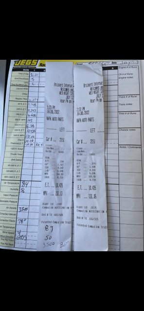

Gotcha. I log every single pass but I'm very data driven. I can spend 30 seconds looking at my log when I get back to the pits and know exactly why something happened, or didn't happen, even down to prep being a variable. Seems daunting at first, but eventually it's like seeing the woman in the red dress when staring at the Matrix code :ROFLMAO:
I played with tire pressure on my ET Street Rs in Michigan. Instead of lowering, I raised them and the car picked up 3mph. I was shocked it was that much.

I kept a log of every run for 4 years EE4EE899-A006-4598-9D16-7B4CCB67D6DD.jpeg
I can and try to predict the et before each pass.

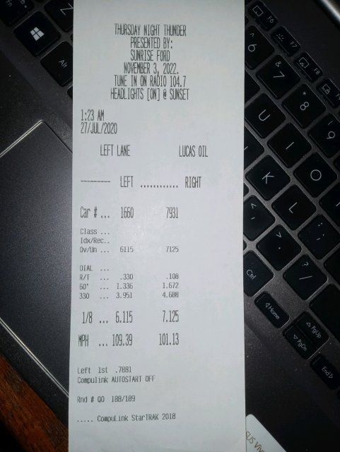

OK, So Irwindale was a blast this week. 1.5 hour delay when one guy oiled down the track 3 cars in front of me. I stood there the WHOLE time and watched them clean up. The fast cars run singles in the left. But the oil down was on the right. They rig sprayed the whole right and it looked amazing after the cleanup. I was planning on going in the right. Then the VERY NEXT CAR oiled down and crashed in the right lane. Everyone was freaked out because they thought the cleanup was insufficient and was the cause of the crash. I knew better. So, another 1+ hour delay. The motor got a really good cooldown. So it makes more power and the DA was heading D O W N. So they ran a bunch of slow shit just to prove the track out before they let the fast cars run. So we had to sit right by the water box while all these knuckleheads funneled around us and proceeded to jack the track surface up. So I DID take the right and the car did not make a good pass. All that waiting for nothing.......
But the DA went down to 100. Rare at Irwindale. So for my last pass I took the left. On this taller Hoosier and with fuel that could be a little better, the car busted out a 6.11 with a 1.33 sixty foot leaving at a conservative 1500 rpm. DANG, I will take that. Since it was so cold the car was wobbling on this pass and I am not 100% sure but I think it was running out of gas. Maybe sloshing fuel? The level was not THAT low. It was hard to tell, but I stayed in it because I KNEW the DA was killer. On better prep this car will be in the 6.0's when set on kill.
BTW, it will take a 6.06 to beat Nephtali's 9.504 in the Quarter Mile. I am coming for you......... In Huston I think I can do it.
BTW the MPH was almost 112 on that less than ideal pass before this. So this likely would have been 3 MPH higher or so.....
