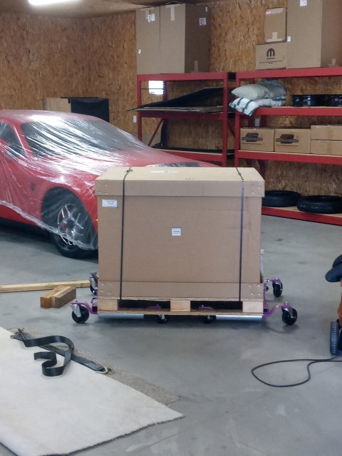

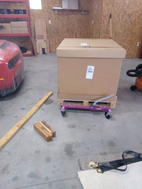

It's amazing what an 8' Strap and a 4' Axle strap and a 10'X2"X4" lever and a few blocks of wood and 2 floor jacks and a milk crate can do. I have been conceptualizing this for a while and finally got around to doing it today. Will fit nicely inside the Trailer in front of the car.
