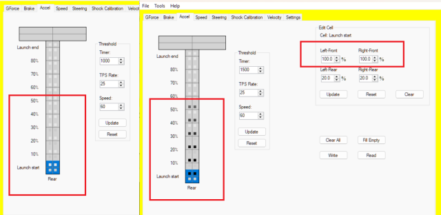

Great summary @rayzazoo. I really CAN feel the independent shock control just driving down the street. That is one of its big differences that I have enjoyed.
The one item that looks interesting is the comfort numbers, and the most easy to change. Less is softer as the default or at no input from driver. Sport rides more soft than street! I am going to drive it a bit today and see if I can feel the ride difference btw Street and Sport. I’ll start there.
Let’s hear more about the acceleration deal. Ray says 1500ms, I may just change it and see if I can perceive something there too. :p It can accelerate if I want it to.:rolleyes:

I think it'll be dependent on the setup. Once you hit 60mph or the threshold timer, the acceleration table is done.
So let's say est. 0-60mph - threshold timer = time not in accel table
Hellcat 3.7 s - 1.5 s = 2.2
Redeye 3.4 s - 1.5 s = 1.9
SS 3.25 s - 1.5 s = 1.75
Diablosport only spent 1 second in the accel table while DSC had 2 seconds. When Mike from DSC was made aware of the DS controller, the feedback was 1.5 seconds might be the sweet spot, but that was also for a 2015 Hellcat. Once the timer is done, it goes back to the GForce table and %.
Another thing to consider is actual 60ft times. If these are <2 seconds, then it helps explain why DiabloSport elected for only 1 second vs DSC 2 seconds.
I think a more accurate measurement is log personal 0-60 ft times. Then tweak the threshold timer.
Next, tweak the acceleration table % on the desired amount of front and rear.

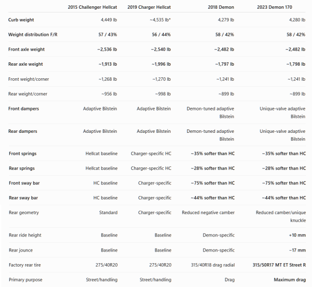

Interestingly, the 2018 Demon launch suspension strategy: "Bilstein adaptive dampers are set to firm up compression and rebound in the rear while softening front rebound, letting the front end rise freely as weight shifts entirely to the back wheels" Great for a wheelie.
Then the 2023 Demon 170 "raises the nose more slowly, putting more energy into forward acceleration instead of a dramatic wheelie." Slower front rise.
Between these observations and @catdad settings of 100 (firm) / 10 (soft), it could explain why it's a more planted feeling with little to no wheel spin.
Controlled front extension with maximum rear compliance—reducing wasted pitch and oscillation while maintaining rear-tire loading.
That is much closer to the Demon 170 philosophy than the factory DSC 10/20 soft-front/soft-rear launch map. @catdad phrase “a ton of pressure on the rear” is describing rear-tire loading, not firm rear damping.
Comparing the G-force table at 0.6 and Launch Start accel table:
OEM launch calibration
Front: 60% → 10%
Rear: 80% → 20%
Both ends become dramatically softer. The front can extend easily, and the rear can compress easily. This encourages weight-transfer motion, but it can also create more pitch, oscillation, or wheel hop.
User calibration
Front: 60% → 100%
Rear: 80% → 10%
This is a radically different strategy:
Front becomes much more controlled.
Rear becomes almost completely released.
It is best described as:
Firm front, very soft rear.
The acceleration itself still transfers load rearward. The stiff front controls how quickly the nose moves, while the soft rear lets the suspension absorb the torque application and load the rear tires.
For the 100/10, it could be more effective on an unprepared surface or street-oriented tire when the problem is immediate wheelspin.
The DSC 10/20 setting may work better when the surface is prepared and the tires can tolerate a more aggressive weight-transfer event.

The acceleration table Launch start.
When launch is activated, the threshold timer of 1-2 seconds applies.
10% front / 20% rear is 400 mA front (soft) / 400 mA rear (soft).
100% front / 10 % rear is 100 mA front (stiff) and 400 mA rear (soft).
Outside of the "box" >0.25 g and acceleration launch, the G Table applies.
Using 0.6 g and 0 left/right results in 60% / 60% front, and 80% / 80% rear.
Applied to the Shock Table
Tour is 200 mA front (softer) / 100 mA rear (firm).
Sport/Track is 100 mA front (firm) / 100 mA rear (firm).
The best part is that you can customize individualized Acceleration Launch Tables for each Chassis setting.
For non-drag racing, the way Mike explained the difference between OEM and DSC is independent references per corner and has a lot more table value references. This helps explain the smooth transition in turns which feels more controlled.

I'd really like to figure out how the 170 is calibrated
8,877
7,790
I would like to see what the "stock settings" for this would be for hellcat and demon 170, I wonder if they can figure that out

Yeah, I'm curious if the DSC could mimmic the 170 suspension settings or if they're going about it completely differently

After messing around with the acceleration tables and testing, DSC is probably one of the most underrated Hellcat driveability mods.
I tweaked the acceleration table to firm up the front and soften the rear dampers during 0-60mph acceleration. This created a "wedge anchor" that reduced front nose lift, and controlled weight transfer to the rear for the threshold timer value. The other benefit is applying this throughout the acceleration table so you could apply it throughout regular driving. Then you can customize Normal, Sport, and Track to have their own independent settings. Independent testing will determine what acceleration threshold timer works best for you. After trying 2000, 1500, 1300 and 1000, I found 1225ms worked well for a 2015 Hellcat with stock suspension and Michilen PS4S tires. This also considered steering feel. I found the greater the threshold timer, the stiffer the steering felt. Too little resulted in oversteer. Too much resulted in understeer.
If drag strip racing, you could go the same route as @catdad with firm front and soft rear and threshold timer for a prepped drag strip and drag tires. Finding the right threshold timer that works best for straight line will be a mix of how well you hook on your tire setup. Test, test, test.
If track racing, it was surprising that all modes had a soft damper setting 0-60mph during acceleration at all 4 corners. @DGatzby, I think this is where there can be a real benefit in Track Mode. Instead of leaving the Accel table at the full 400 mA front / 400 mA rear range, you can tune it closer to 200 mA front / 100 mA rear. This reduces the amount of chassis movement under initial throttle and creates a smoother transition into the G-Force table, where much of the Sport/Track calibration is already operating around 200/200 or 200/100 mA. For the track acceleration table of 10-80%, I put 50 LF-RF, and 20 LR-RR.
One test where this really stood out was a 90-degree corner: approximately 55 mph approaching the braking zone, slowing to about 25 mph at the apex, then accelerating through the exit to 70+ mph. As throttle came back in, the car stayed composed and held its line through the apex and exit rather than developing the noticeable front-end rise and chassis movement felt with a 4,400-lb Hellcat out of a corner.
The result wasn't simply a “stiffer” suspension. The car transitioned from braking → cornering → acceleration as one controlled movement, which gave much more confidence getting back into the throttle on corner exit.

Thanks @rayzazoo , while some components are different, the magic comes from their suspension settings for the shocks in drag mode I believe. It would be nice to see a dump from a dampener module from a 170, I assume DSC would have had to do this with a regular hellcat in order to develop their software

Everything describe in the launch of a Demon 170 is letting the front rise while controlling the rear.
Almost like anti-squat. Rear of the Demon 170 also sits higher.
You could recreate the Demon 170 strategy in DSC during launch and acceleration:
softer front damping to allow front rise, firmer rear damping to control rear compression.
Limitations would be the remaining hardware.
Alternatively, @catdad did firm front and soft rear. That seems to use the OEM springs and a more controlled front end as a leverage point, while allowing the rear suspension to compress and accept the weight transfer. This strategy might work better with the suspension hardware already on the Charger Hellcat.
Comparatively, I tested a softer front setting for Challenger Hellcat. Calculated, the Charger has approximately 80 lb more static load over the rear axle than the 2015 Challenger and a roughly 4-inch longer wheelbase.
I'm not sure the same strategy would be optimal with a soft-sidewall drag radial but seems to be working for @catdad.

With a little help from AI, I think we collect the hardware variables and use all of the geeky math to see what DSC configurations could work.
I think the table below is noteworthy for rear axle weight comparisons.

Thanks Ray! I got done with my part of a major home project Friday. That is going to allow me to get into this now. I am fired up because my car really feels good! We took a 500mi round trip with the Durango. I want the Durango controller also, it rides like a truck with sharp rebounds and feels bad now. Wow.
I know at this point anyway several things..
- it is not the DS unit at all and seems to have almost enhanced different and fundamental control.
- whatever the settings are in Sport Mode from the neutral ride to how it then behaves, I am going to like to make those settings my street (default).
- I have done a couple of these 90 degree bends also. Besides the perception you describe about firming up the sway dramatically, I have a 90 with a downward hill also. It makes that turn fairly aggressively (fast), and besides this more stable feeling the tires are silent!
@rayzazoo I need to understand a lot more around which screens (settings) and how we are entering the numbers. In the short time I viewed the “tune” downloaded from the car, I don’t see anything but blank entries, except for the first screen that has the % shock values and the acceleration screen. I have until Oct 17 before putting it on the track at RA, to play with the Track settings, and then want to understand the system so depending on how she works I can make some changes on the fly.
Can I ask for some help to better understand where, how and what is going on with the mA settings? Where are the fundamental rebound settings, or as we increase these is all that taken care of either to a lessor or greater degree? Let me know if you can help. I am also going to watch all of their tutorial library today. Hope to be smarter soon.

Without the actual values, everything describe in the launch of a Demon 170 is letting the front rise while controlling the rear. Almost like anti-squat. Rear of the Demon 170 also sits higher.
softer front damping to allow front rise, with firmer rear damping to control rear compression.
Alternatively, @catdad went the opposite direction — firm front and soft rear. That seems to use the OEM springs and a more controlled front end as a leverage point, while allowing the rear suspension to compress and accept the weight transfer. This strategy might work better with the suspension hardware already on the Charger Hellcat.
Comparatively, I tested a softer front setting for Challenger Hellcat. Calculated, the Charger has approximately 80 lb more static load over the rear axle than the 2015 Challenger and a roughly 4-inch longer wheelbase. This approach produced noticeably more controlled 0–60 mph acceleration on street tires, with less excessive front-end rise.
Compared to the Demon 170 it's ~ 54 lb apart. Yet, Dodge made the Demon 170 front springs approximately 35% softer, rear springs approximately 28% softer, and dramatically softened the stabilizer bars.
A drag radial may benefit more from allowing front extension while controlling the rear, closer to the Demon 170 strategy.
