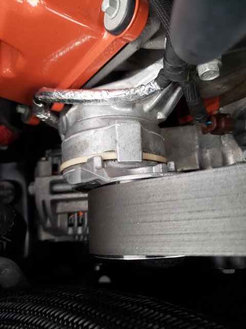

Did the Dayco fit? I just installed new idler and tensioner pulley and my tensioner is to the left side like pic a few posts ago. Once I put the plates in there will be no way the belt will work. I was looking at the gates hd belt 100582 but I don't want the green belt 20200531_123046.jpg

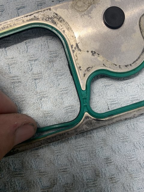

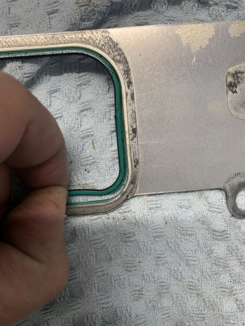

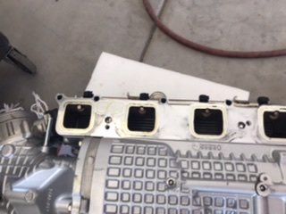

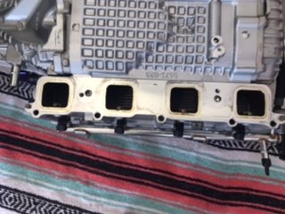

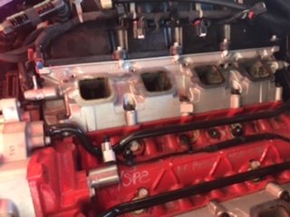

So I did this exact mod and took her to MIR over the weekend. Good times had by all, not a single issue with the car. Boy am I glad I did the swap sooner rather than later. The gaskets where letting oil blow by, the crank case was definitely pressurized. Take a look at these POS gaskets.
25,692
#53
The ones from my Hellcat looked ok but the Redeye had some blow by for sure.
65222C81-64BE-41FD-9D2B-F3BA36D96019.jpeg 47F6B028-DC20-4D97-A282-A6DF2EBEBA56.jpeg 7A8ED401-0F2D-4578-925E-DD9DEBC26ADC.jpeg 7461457D-E8DD-46CD-8376-6A860AF62D1F.jpeg
#54
My IC was pretty much oiled up... I'm glad I got rid of the bad gaskets when I did. I could only imagine how that engine was feeling after being driven.

Did the Dayco fit? I just installed new idler and tensioner pulley and my tensioner is to the left side like pic a few posts ago. Once I put the plates in there will be no way the belt will work. I was looking at the gates hd belt 100582 but I don't want the green belt View attachment 18034
Yep, Dayco worked like a charm. My tensioner is almost perfectly centered.
got the Dayco from amazon ! Easy peasy !!
on a side note, I strongly believe that whatever issues there may have been with the belt alignment after the spacer install must be due to people not replacing the dowels on the bottom of the supercharger with longer ones.
they locate the supercharger precisely where it needs to be. Without those, you are relying on eyeballing plus the bolts lining it up for you.
Remember that openings for the bolts on the supercharger and on the motor are slightly bigger than the Bolts themselves (to allow the bolts to go through). This will cause you to be off alignment ever so slightly, which may be enough to cause issues withe the belt when it is under load.
the dowels On the supercharger and the holes for the dowels located on the motor are a super tight fit, ensuring there is no room for play.
take the extra steps and replace the dowels. They are super cheap and you don’t need any special tools to take the OEM ones out, just patience. Worth the peace of mind, in my opinion.
