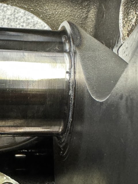

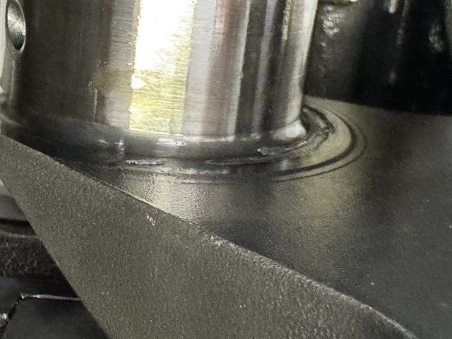

If it was an oiling issue then the cause is not with the main caps. What do the journals on the crank look like. What do the oiling ports on the journals on the crank look like? The caps have one purpose, that is to keep the crank attached. That's it. What do the bearing journals look like?
The oiling issue was because with the cap pushed off it seat the crush on the bearing shells was not there any more and the main bearing shell rotated just enough to close off oiling to the journal and up to the rod journal and caused a rod failure. If the studs would have been strong enough to keep the main caps in place none of that would have happened. Root cause was main studs did not hold caps down tight and allowed other things to happen because of that. The witness marks on the caps says it all, they were doing that for a bit before things progressed to failure. They were ok at 1000 and 1300 to the tire but did not like 1500 to the tire. The purpose of this thread was to point out the weakness of this engine that lead to failure was main studs due to material type were not up to the power level being made.
Journal on the crank looked fine, journal on the rod did not, was starved of oil due to the bearing rotating about 30 degrees from where it should have been.

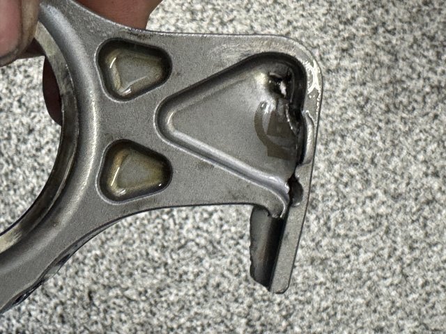

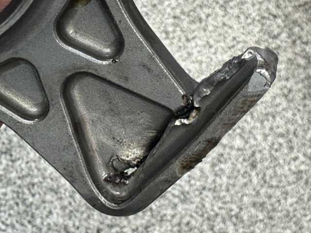

Main bearing spun, blocked off oil to the main bearing, starved crank and rod of oil. No heat in the cap, no sign of the bearing spinning on the cap. What am I missing? Can you show a picture of the rod that failed from lack of oil?
3,806
9,018
Thread Starter #46
Bearing only moved about 30 degrees, just enough to move the oil inlet slot and close itself off, did not fully rotate and spin. that crank journal had enough oil to lube itself enough but nothing up to the rod. The rod somehow side welded itself to the crank and spun with the crank and sheared itself off on the block and then spun with the crank like it was a welded on balance weight. Weirdest failure ever!, windowed the block, did not even damage the crank visually but it was not reused. B094D90C-AA86-44C1-B367-12BB5BEB8063.jpeg IMG_7729.jpeg E3EB8185-3681-4CF8-AFA9-C7D04F1C44A7.jpeg 4CBE9659-73B4-4F17-8109-AF4FB4191A54.jpeg

@16GoManGoHC2 E had a rod failure like your pic where it windowed the block. TK and Boostline found the engine had rods installed that were supposed to be pulled off the shelf and were install by mistake. Any chance that in addition to the bearing being partially spun that the rod could have been in a defective batch, possibly bent and sending vibration through the crank?
3,806
9,018
Thread Starter #59
Could very well have been. But the witness marks on the caps are still telling a story that they were moving around and probably was doing such before the rod failure. That was the main thing to point out in this thread, cap walk, what it looks like and its causes. It can happen on rod caps as well, same look.
