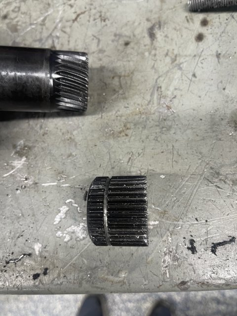

G force axles is this a problem????

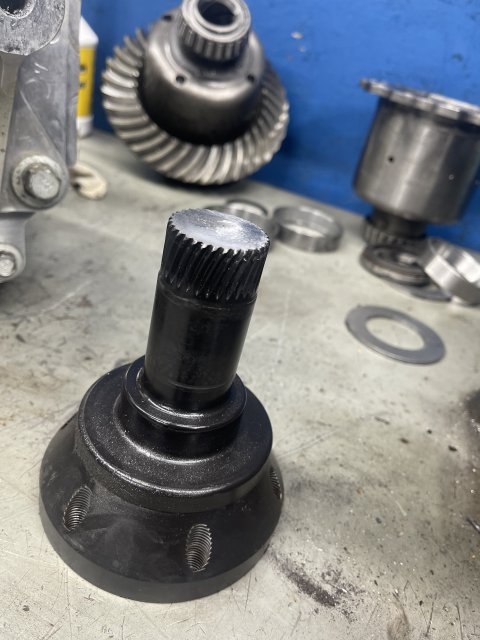

Yes they are two days on the inner stubs. They said installed wrong looks like a clean break to me. It’s broken right at top of the spines in the diff after the clip seats

I calling that as BS that’s as clean break as anyone can see ! Something is not right and I’m sure you’ve put enough axles in . So now the next question who the hell makes a good set of axles?
Am I forgetting something or overlooking something?
It's not really possible to install wrong relative to that break, with the assumption that the outer suspension didn't fail first in some catastrophic way allowing that spline to disengage with the diff.
When it broke I thought it was the new wave track carrier I put in. It broke right we’re the splines end in the diff

That looks like spline and a half of twist. In that few runs I would think they're soft.
16,900
52,912
It wouldn't be hard or expensive to throw them on a hardness tester.
So there is more then one way to put an axle in:unsure:
From what I have heard about DSS axles I wouldn't buy them it is the only other choice. Guess I would be looking at talking to someone else there at gforce
I had an input shaft on a trans that twisted. Strange engineering was who made it and they said they wouldn't replace it because it didn't snap. I had the trans builder replace it being it was apart and only $300. Being yours did snap it should be replaced by them
