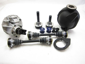

You don’t need a nine inch. The factory ring and pinion is a nine inch. And spending 10,000 for a nine inch puts the stress at the hubs and they break.
long and short G force does not stand behind their product period. When you have a problem they blame everything but their product. Look at splines clean break.
you can offer a lifetime warranty on anything don’t mean you honor it

Ok here is the Top of the line combo of some friends who race their 8 sec Hellcats.
https://highhorseperformance.com/billet-hellcat-differential/
And the DSS Axles and halfshaft 😎

That rear may be my next purchase. I like that I get to keep my axles and braces. Plus the added piece of mind that my diff isn’t going to explode on any given launch.

It’s an after market case with stock internals. I would put a better carrier in the stock clutch’s suck
