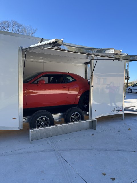

Is that a bar welded to the rear cradle for jacking up the car from??
I’m sure you could use it for that, I always thought it was for a place to tie it down from in the trailer if you wanted to. IMG_8238.jpeg

Very nice! Yeah, I guess that could be used for tie downs
