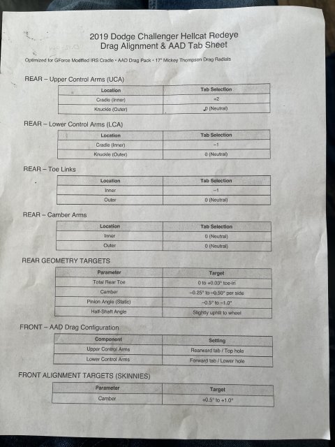

If someone could provide a link or direct me to a post with alignment specs I would appreciate it.
Thanks
3,633
11,722
Factory specs in the front. Positive camber in the rear. I ended up with +2 degrees. Ran 1.25 sixty with that on a 315/60R15 Radial Pro. Key to straight line stability is zero toe in the rear. Make sure that if there's any error, it's to the inside.

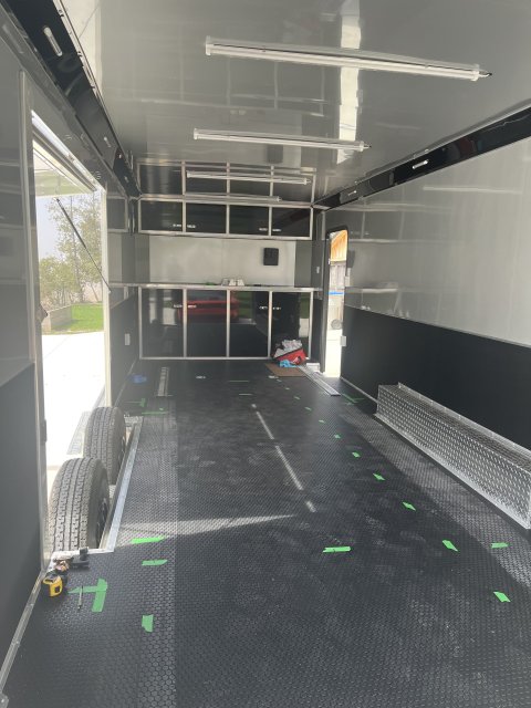

It looks like the weather is finally on our side. Just figuring out where to install the etrack and the car goes in Wednesday for an alignment. Weather permitting I have been invited to a private track day May 9th !! IMG_7932.jpeg IMG_7928.jpeg

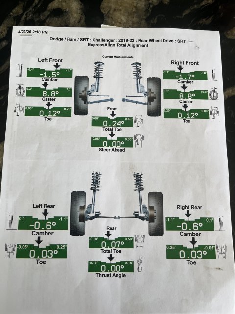

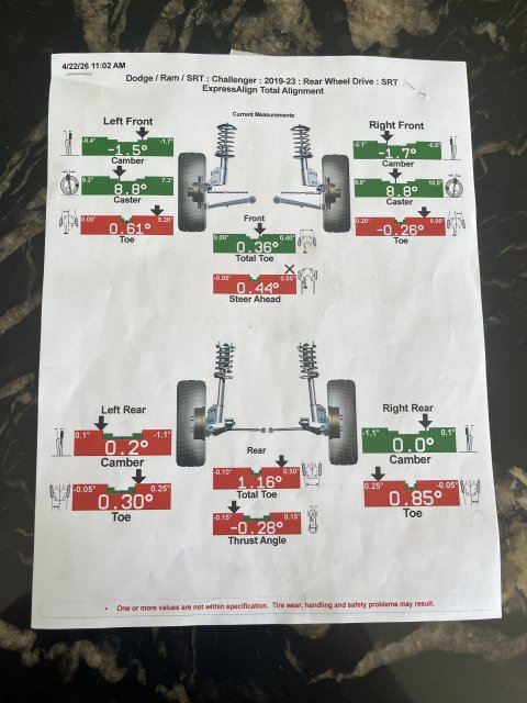

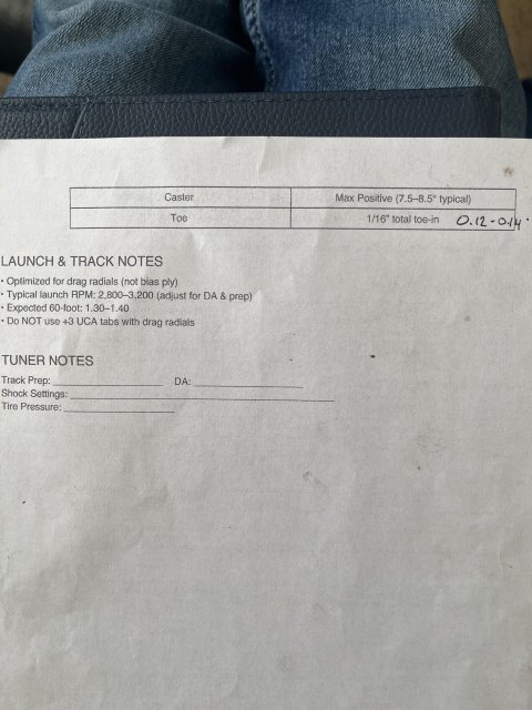

So I actually found specs that are supposed to be “optimal “ for my Gforce modified cradle set up and I had my car aligned today. Everything seemed to work out fine other than a possible u-joint that is failing and the likely suspect for the noise I was hearing. So for what they cost I am just going to replace the u-joints and hopefully that issue will be solved, but you never know. IMG_7940.jpeg IMG_7941.jpeg IMG_7936.jpeg IMG_7937.jpeg

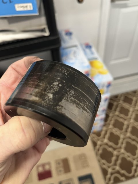

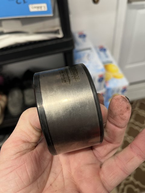

So I decided to replace the tensioner and idler pulley with the Metco product as I did notice that although the bearings seemed ok it was visibly obvious that the belt had been slipping on the pulley as seen by the pictures below

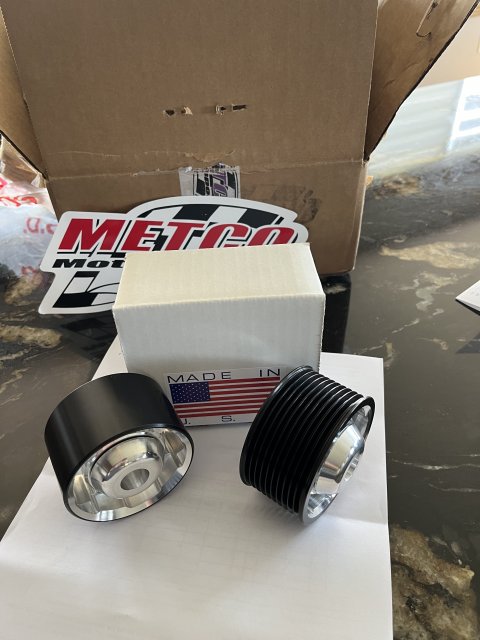

The Metco pulleys not only looked a lot nicer they were considerably lighter. IMG_7974.jpeg
