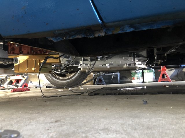

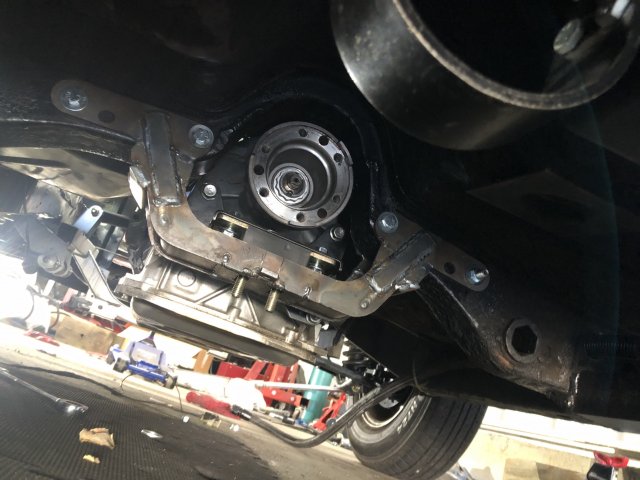

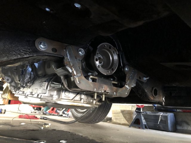

Pics are without the shims in the crossmember so the trans will come up a bit more and level out the engine. Not really happy with my work, welds and work was rushed and sloppy but definitely structural. Tough doing all this in a cramped 1 car and in a rush after working an overnight shift at work LOL. I mean hell, would have loved to TIG weld it even but this build really needs to be running by fall and there's so much more to do. IMG_9519.PNG

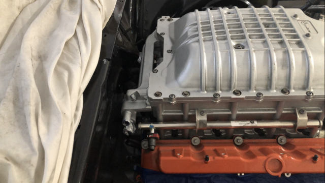

I'd say 1% chance on pulley failure at 15k miles. Just saw grease in the original pics so wanted to mention to check it.

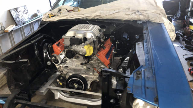

Not sure if this is allowed here, but I'm dropping a 15k mile 2018 6.2 Hellcat and 8hp90 into my 70 challenger and figured it might be cool to share. Obviously a lot of the swap stuff doesn't really concern most here who have actual hellcats, but figured I'd share some of the things that might be helpful (motor specific stuff).
