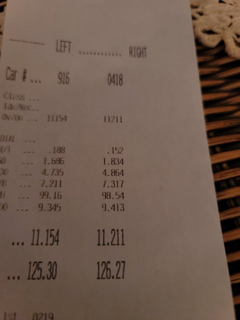

Horrible 60' times in hellcat
18", 18 psi. definitely not hot enough. i load it like 900 rpm or so and tap/smash too. maybe im also too quick, want that 1.6 time and i turn off traction control to do the burn out and then just send it.

Its a stock hellcat, and im running 18" nitto nt05s at the drag strip.
it seems 98% of all my runs i get a 2.0ish 60' time.
no point in more power if it doesn't hook.
heard that i should get a good 1.6 time with the stock suspension.
i run the suspension on (street) and traction (off)
everything else is set to track.
I roll into the throttle when i get the last yellow.
my best 2 runs last year i got 1.62 times, but i really smoked the tires before i launched.
gets frustrating, all these 2's for my 60' times.
I'm going to try the mickey thompsons this year.
any thoughts/suggestions?

As of this weekend I have 71 passes and I got (2) good 1.62 times at 11.21
Need more practice, and seat time. 💺

I am assuming this early in the season it is pretty much just test and tune.
If it is are there a bunch of cars on street tires? Is the track prepped?
You shouldn't have to spend a bunch of money on suspension parts on a stock car imo.
The track is at low elevation and at this time of year the air is pretty good. Not late fall good but better than August.😉
The 11.2 with the 1.62 60' has me wondering if something else is up.
What does the rest of the slip look like?
Mph gain from 1/8 to the 1/4?
In cool air you should be gaining between 25mph on the low side or 27mph like mine does.

Yeah its a test and tune. And I should have posted this already....
#37
That's about what my Charger ran when it was stock.
Chargers are a bit slower than Challengers when stock for some reason.
