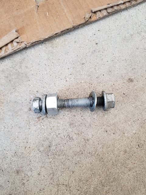

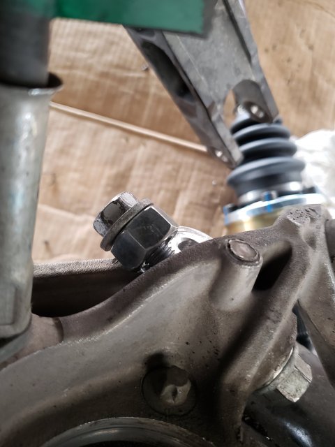

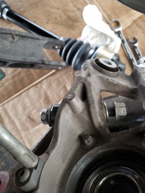

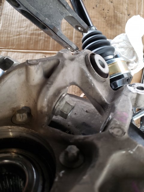

This has come up before and Jon found a way to do it but after having an issue with his bolt I figured out an easy fix. Once you pull the knuckle off there is a little sleeve that sticks out making it impossible to get in back on. All you need is a bigger nut or small spacer to fit over bolt and a washer but it may not needed in a pinch. The bolt and nut, you have them lying on the floor from disconnect the arms. They are 18mm and all you do is tighten them and it will push the sleeve in. I used 2 18mm wrenches 20230924_111702.jpg 20230924_111636.jpg 20230924_111628.jpg 20230924_111641.jpg 20230924_111227.jpg
Yep, I also use the bolt trick

Yep. I found that trick somewhere in one of the forums. I went the other way though--threaded through both sides and had it push outwards from the middle. Good to know it works that way also--might be even easier.

I tried that and had a massive whack series with a mallet to NO AVAIL.....ended up using a little grinding to bevel the very edges but am wagering it was all about the angle is was being oriented in and I could not do it one person job.....had a buddy come help who had changed his axles out before and he held the HS while I moved the hub to get the axle lined up and the parts were able to be lined up correctly.....bit of prybar action and it was done.....lesson learned

Once you get that bushing pressed through it goes on easy--one person job--slid right on for me.

I did it myself also. One reason I posted it was if someone has an issue they may be able to find it in a search. I know I have searched for help on different projects
