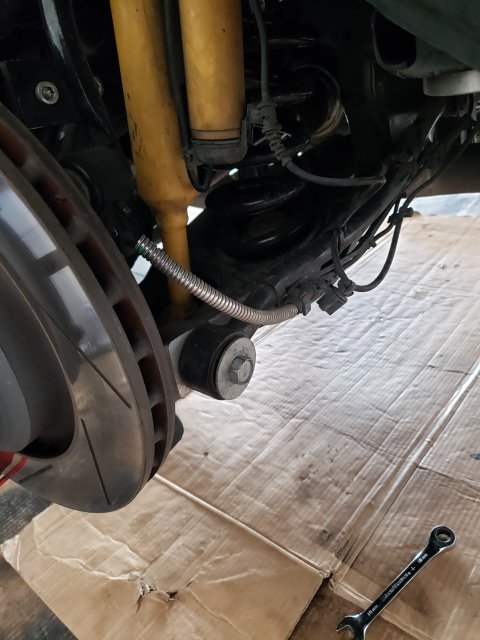

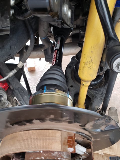

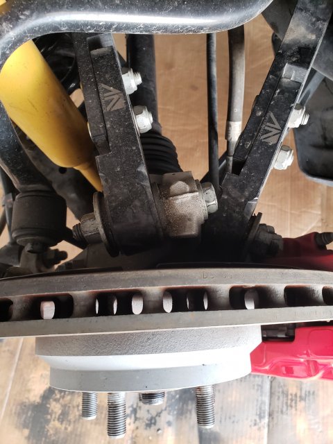

You unbolts the upper control arms, trailing arms, sway bar, knuckle, alignment bar and come out the side 20230924_121053.jpg 20230924_093117.jpg 20230924_093057.jpg
