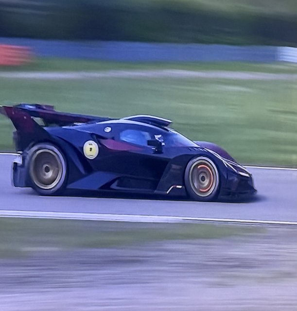

Thought this was interesting. I was watching “supercars” on Nurburgring track. I got flagged once for glowing/flaming front brakes. I stopped using Porterfield pads after that. I am sure this his normal, but it looks like the driver must have been running it pretty good.
