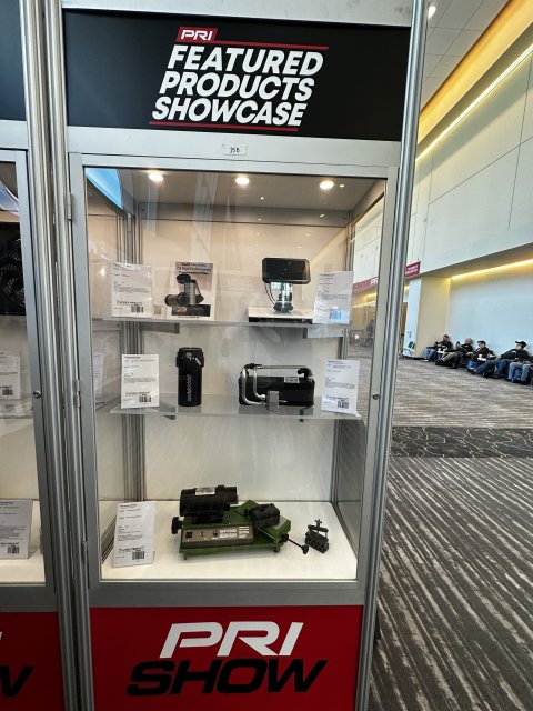

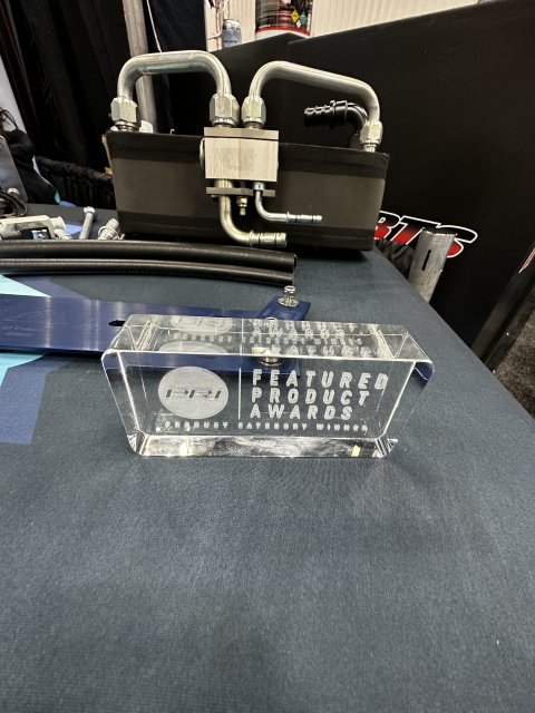

All - We went to PRI Show and won the product showcase award. We really appreciate all the members who supports us and always spreading the good words about us.
U
8,586
7,552
Thread Starter #198
Congrats! Great product!
