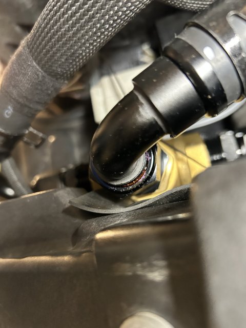

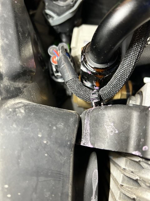

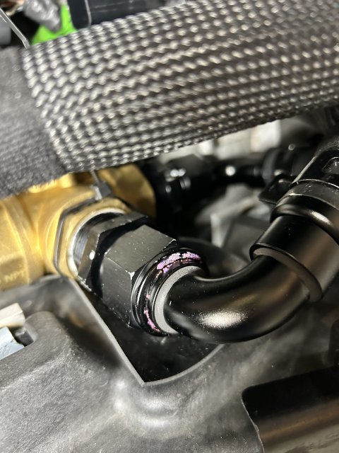

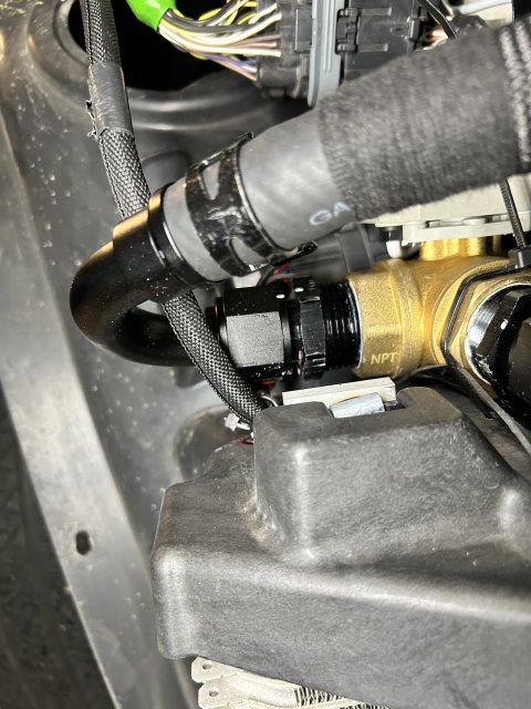

Dang it. Too loose? Hand tight then snugged tight using two 8" wrenches. Or just bad ones from Amazon?

Hand snug then 1/4 turn. Both mating surfaces need to be perfectly clean.
View attachment 173667 View attachment 173668 View attachment 173669 View attachment 173670
AN fittings are a lot more temperamental than most people think. You are trying to get it to seal with just metal on metal. Always make sure the surfaces are clean and spread a little new motor oil on the flare before assembling. It's good to start out snugging them up and applying some force. If there is a leak, you can go tighter. For -12AN, you can actually go to 40 ft/lbs. To do this accurately, use a torque wrench with a crow's foot clocked at 90 degrees to the wrench handle. (There are tutorials for this.) I have had to go to 40 to get something to stop leaking before.
That being said, all AN fittings are not created equal. I have used Amazon ones that would NEVER form a leak proof seal. I like RaceFlux for quality without an insane price. I have never had an issue with one of their fittings. Plus, they do some clever stuff here and there. Like, their caps have the flare but include an O-ring for added backup. Good luck man!

None of my raceflux AN fittings have leaked. I only have a few from Earl's but they seem to be of good quality also.

This is with vibrant fittings, so not cheap ones.
U
8,585
7,544
Thread Starter #419
I'll never use AN fittings ever again for coolant

I'm redoing mine this weekend. Keeps leaking past the PTFE paste under the paste through the threads. I have Loctite 567 now, should take care of it. Also cutting off the other fixed 90 degree fitting on the right side so I can spin it and put on another pivoting npt to 12an fitting (I have the old style brick). Installed an adjustable one on the left side so that I can move it where I need it and I'm happy with it, actually not leaking on the AN flare side there that goes to a female 45 degree barb
