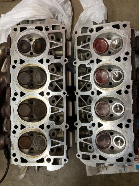

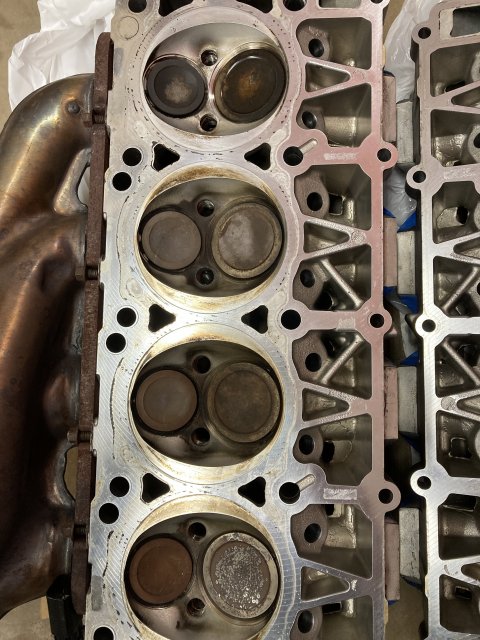

Never used the cleaner but after using it for 9-10,000 miles 1 qt of Octanium Unleaded per 15 gallons of fuel (1 can every fill up) I tried every industrial cleaner I could get my hands on including MEK, Triclorethyne, lacquer thinner, gasoline, kerosene, oven cleaner directly soaking it for days on the valves of my heads turned upside down nothing short of a dremel and sanding disks took it off the exhaust valves. Worse was the seats both on the valve and in the head only way to clean them up was lapping compound. My days of MMT use are over!! Took a few evening to clean things up. I at one time swore by the stuff, now won’t touch it or recommend it’s use, in fact I discourage it now. 889E2313-EE4B-479F-9095-B2AC72BED5EE.jpeg D35DA093-D060-4E8A-A9F5-F2CC00C2ABDC.jpeg 06A7620E-7B24-47D6-A5E3-BA8C8D8CB9AF.jpeg C9C85033-F5D5-4B46-BB3B-66F42BB4E4F8.jpeg 6249281C-A1D3-4804-BCC6-03D8342A2DE4.jpeg 0042355E-7987-40BF-A7CD-357D332CED9C.jpeg 28671941-4F71-4BB6-81A8-BC9845EB3F8D.jpeg 0C012EA5-F5F2-4F4D-B919-423FB414189A.jpeg 6EB86C17-1A0E-4036-9681-7057D47BE6A7.jpeg 2303A2E0-4AFF-4375-BC0F-9C52E2E8B538.jpeg

I don't see 1/4" buildup of residue that's been stated by some.

You better look closer then.

That is well over 1/4" if you use what's known as the "internet measuring system". LOL

Look at the indented tulip on the exhaust valve, see how deep the clean ones are? Now look at the dirty ones, some are almost flat to the top, the tulip is gone. That tulip shape increases surface space so valve can get cooled some by the incoming air and fuel charge. Take away the surface area take away the cooling area, worse yet add a layer of insulation (MMT build up) over the top of it and it starts to get real hot. What happens to a hot valve? Valve stem clearance disappears and you start scoring valve guides or worse have a valve stick open and the piston will sure help close it for you!!

How deep are the tulips in the exhaust valves Mike? I KNOW you measured them? At least 1/4 inch or are my eyes playing tricks :)

Almost 3/8” deep
