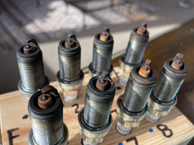

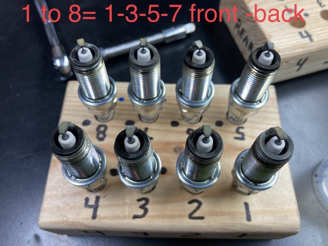

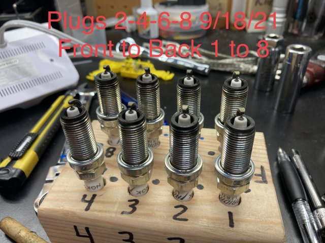

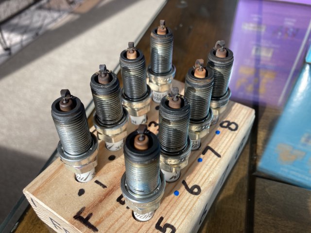

I’m no long time E85 user and not defaming your post here Jim but I just don’t get the how going to 93 cleans things up from what I have seen of what plugs and pistons look like running E85 verse Gasoline.
Plugs on E85 for 2500 miles
60877A92-C2B3-46BB-B9FD-E1202A17F78F.jpeg BDC3AF05-E1FF-44DA-B5EC-5EBC93A5C383.jpeg 6B4B6F93-3727-4CBF-99AF-DAEE276D047A.jpeg
Same plugs after just 1/2 Qt of Octanium Unleaded in 10 gallons of gas and 3-400 miles of straight 93 afterwards.
25D84E5B-83A9-40CF-9B8D-ED3D86D1F9F8.jpeg 81767B8B-7A1D-4317-B459-DDA6887A173C.jpeg
Car is sitting with 93 in it, in warm garage for 6 weeks since starting and look at the rust ring where the piston was sitting. This is gasoline not E85!! 99.9% of moisture comes from the air it ingested last not the fuel.
Lucas makes a stabilizer just for E85. It’s what my car was stored with for the entire winter last year. I sent the injectors out to ID to test and clean them, their spread was no little changed before to after. Me, I’m mixed in this whole thing of gasoline vs E85 storage thing. I mean how can the the fuel in a sealed tank absorb moisture from the environment it’s stored in when the tank is air tight sealed?? Especially if it’s filled to the brim with very little trapped air in the tank, don’t the fumes when filling push all the air out so what’s there to be absorbed?
All I know for sure is my plugs looked brand new until running gasoline, that sure cleaned them up??? 🤷🏻‍♂️

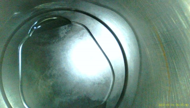

You're kinda missing the point. I don't wanna make this about who's "right or wrong" as that's not it. It's about educating people on what happens when certain decisions are made. Each owner will have to decide what's OK for them.
You can go back and find posts from me when I tested Boostane and my plugs turned orange. 2oz in half a tank is all it took. I don't ever remember that going away even after never running it again, my plugs always had an orange tint from then on that I remember. At the time I just said yeah it's orange so what, but race gasoline was a better option for me personally at the time so I never looked back.
We saw others post pics of their cats and O2s and they were also orange....meh OK it's orange so what. It might shorten the life of plugs, O2s, or cats but so can leaded race gas and those are all really just maintenance items anyway and eventually need to get replaced. If it happens sooner so what, the performance gain is worth it.
Then Mike posted pics of his heads. THAT is when my opinion changed. You do see the exhaust valves completely caked with MMT right? Like 1/4" thick or more? Now DGatzby shows his and the same thing. Replacing heads and exhaust valves is not a maintenance item and that also shows these deposits are cumulative over time. This is not something I would want in my engine and I'd never buy a car that had used it to any degree as a result. You've run it so long it probably doesn't matter now and you've not seemed very concerned so you're "OK" with it but I think it's important that others understand it's a thing before deciding to follow your foot steps there.

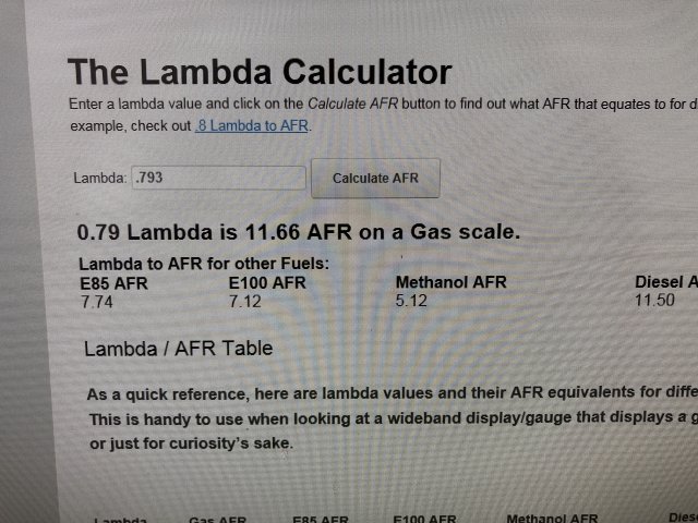

Speedy, you sure on these lamda to AFR conversion numbers for gasoline?
With FAE I’m running around .793 lamda top end with high air charge, I seen to get the best power and least knock voltages there. Am I too rich??
C51ABF84-4DD7-4F69-84F4-D6EAE804B5C3.jpeg 14D1FC69-1B0A-4931-835D-F8C52631D6A7.jpeg
#90
That's on the rich side. I'm assuming this is your e85 tune?
Also to convert from lambda to AFR the stoich you are using plays a part in this. Are your stoich points updated to match the proper stoich for e85?
I stick around .81 for e85 when in Power Enrichment.
As far as gasoline you have to remember Dodge uses 0.0722 for stoich on gas and the value they use in the PE table is
0.011 which converts to .87 Lambde for PE. Which converts to PE 12.02 AFR Stoich AFR13.85

@16GoManGoHC2 your chart assumes a stoich of 14.7 for gasoline. For this discussion I used the Hellcat's stoich point programmed to 13.85 like @jonx96 says. That's why I put the lambda values next to it, that's what we should really talk about. Lambda is lambda :)
With PE at high boost my lamda is .793, this is my gasoline tune. (See alcohol content and PE and Lamda in log pic) It’s sounding like I’m pig rich then but the cars making max power with the least voltage coming from the knock sensors at this setting. If lamda is lamda what’s right? According to this gasoline calculator .793 lamda is 11.66 AFR on Gas scale about right where good safe power should be no?
#93
Lambda is lambda but in the afr conversion you have to take in to the fact of Stoich and the Value put in the PE table is not .79 it is another value and you have to convert it to lambda.
#94
1 divded by the number you have in stoich gives you afr stoich so 1/0.0722
1/(.0722+PEValue) = AFR Power enrichment
7,313
19,175
Thread Starter #95
@16GoManGoHC2 the Hellcat will use .0722 for stoich which is 13.85 AFR. To get what your actual AFR is multiply .793 x 13.85 = 10.98AFR on gasoline.
Richer than I'd set it to, but if you dialed it in on a dyno and made max power at that setting then it is what it is for your car.
The yellow highlight for FA Enrichment is the amount of PE your car is commanding to get to .793 lambda at WOT.
